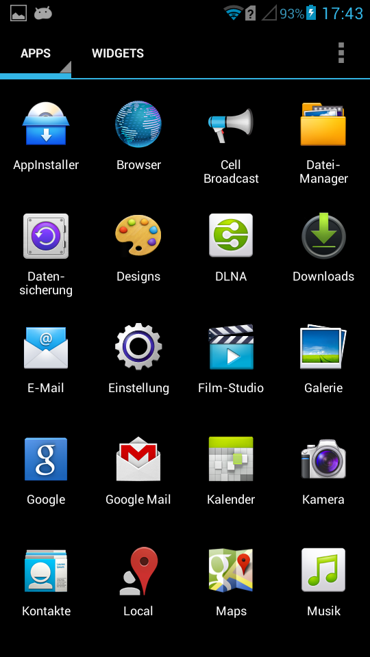

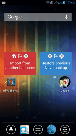

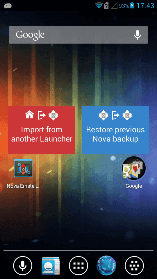

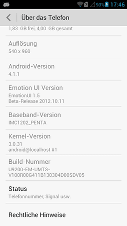

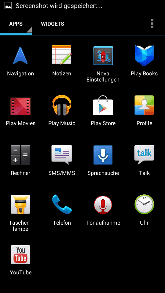

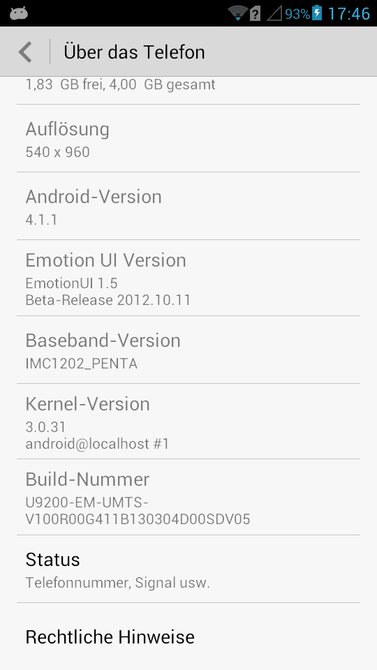

attachment.php
attachment.php
attachment.php
attachment.php

Screenshots im Anhang
