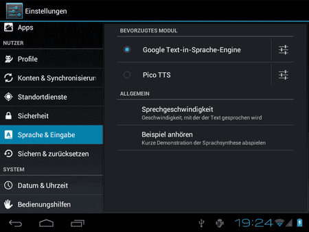

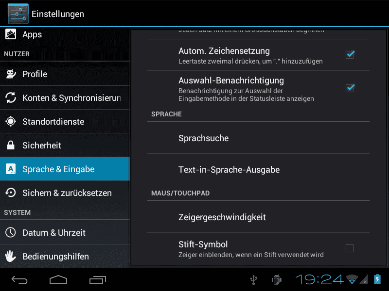

Ist denn in der 1.2.5 Text-to-Speech mit drin? Bei der 1.2.4 ist zwar ein "Pico TTS 1.0" vorhanden aber ich kann in den Einstellungen dazu nichts finden, was auch andere Stimmen für die Sprachausgabe außen vor lässt.
Text vorlesen lassen ist manchmal ganz praktisch. ;)

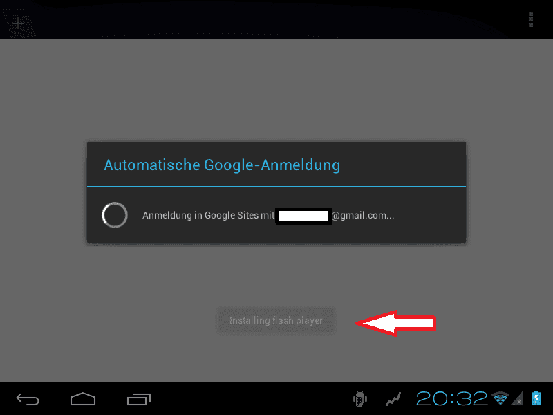

Adobe Flash not working in 1.2.5. Redirecting to Google Play and there - "This app not compatible with your device" - what to do? Thanks
Do not install Adobe Flash Player by yourself. Just open the Browser and it will be installed automatically.

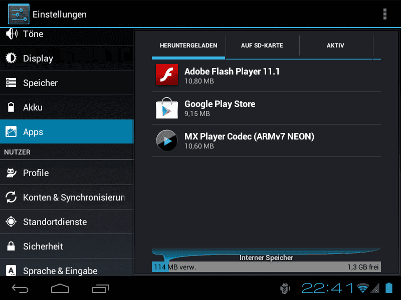

Dear Oma,
when I opened it for the first time it redirected me to Play and there I got "this app.....".
After that, I downloaded adobe flash 11 .apk and installed... still not working.
What to do now?
tjanks
I am sorry to hear that. Normally at the first start of the browser the flash-player will be updated, see screenshots.
Hm, where are you located?
:thumbup:

Solved.
My mistake was: installed 1.2.5 (great work - my respect) and soon after I installed dolphin browser and I started that wich probabbly messed up adobe flash update. Then I installed manualy, .... didn't work.
Solution:
uninstalled the adobe flash apk manualy installed
go to root/apps and delete from app directory flash.apk program
restart stock browser - will update the adobe flash correctly.
regards and greets for the great work
