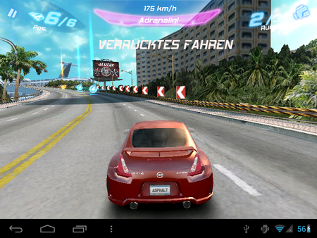

hello Oma,
in this version (cFirmware Oma ICS v1.2.6) is a problem with G Sensor when i play various games
What is the specific problem? In which game for example?
:thumbup:
nfs hot pursuit, racing moto and almost all g-sensor games
Ok, can validate that with Asphalt6
I can correct that for the apps. However, homescreen will then have a wrong orientation. As a workaround
you can fix homescreen by the app Display Orientation (already on board).
Corrections have to be done on kernel side. Will discuss this with Astralix.
Pls test.
:thumbup:

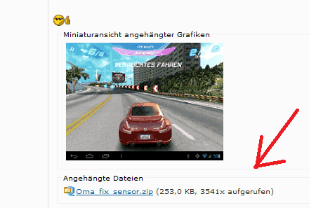

  • Oma_fix_sensor.zip

3541 x aufgerufen - hahaha ;-)
Pls test.
:thumbup:
homescreen has a wrong orientation but in games kernel works fine.:D
