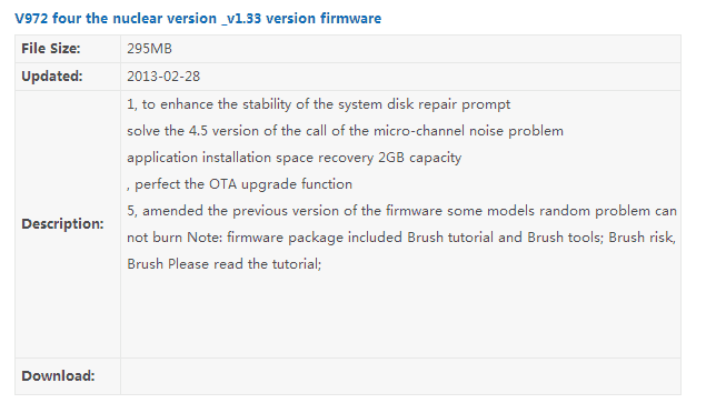

hab ich auch gerade gesehen,
angeblich:
1, enhance system stability
2, to solve the micro message version 4.5 calls have noise problems
3, application installation space back to the 2GB capacity
den letzten punkt versteh ich nicht richtig, was ist damit genau gemeint?

Lt. dieser Info Rumours Onda V972 new firmware notice this week, the 1.33 version make the system more stable! - Gadget Rumours | Gadget Rumours
..hat ONDA wohl diese Woche eine neue Firmware v 1.33 released, welche das System allgemein stabiler machen wird.
Original-Text:
Rumours about a new Firmware for Onda V972 Ver 1.33
Onda has been trying to improve and optimize its quad-core tablet optimized firmware Onda V972 quad-core version 1.33 version tested through today, obviously feeling a smoother, more stable system, compatibility has improved!
