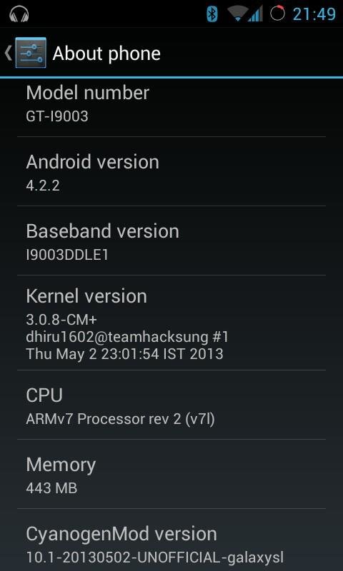

Nach einer langen Durststrecke hat Dhiru wieder die Arbeit an CM10.1 aufgenommen. Siehe Anhang!!
Hoffentlich gibts bald mal ein Stabilen Release von seiner Seite.

Aktuelles Statement von Dhiru:
I am still alive and I am doing great. Life has been getting harsh on me and I was not able to make substantial progress. I have been contributing few patches to I9300 but nothing great.
I see there has been a lot of progress with 2.6 kernel, however since me and Adipat have made the effort, I am planning not to go back in time and work on 2.6 kernel again.
I will try to devote sometime for SL. I need to get the reboot option working in the kernel.
