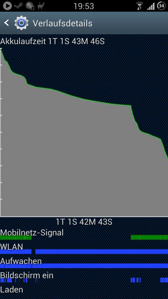

Abend,
Woran könnte das liegen, dass der in den Deep Sleep geht?
Ich hatte das schonmal, anderer Kernel geflasht und fertig. Jedoch will ich dieses mal beim Hellscore bleiben.

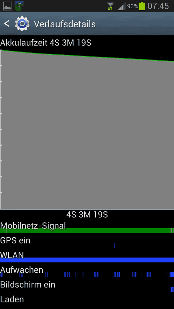

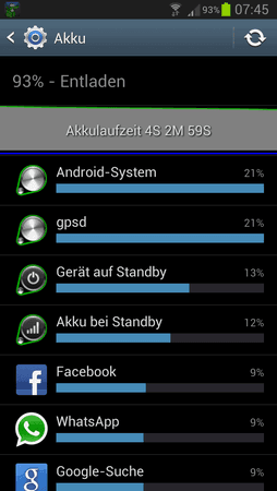

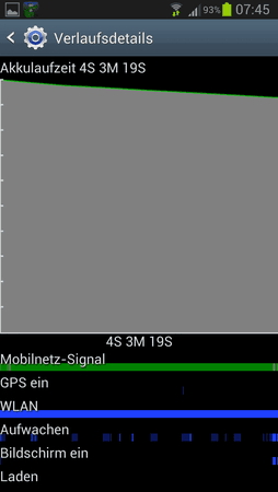

com.google.android.gsf (): Wakeups: 214
Alarms: 14, Intent: com.google.android.intent.action.GTALK_RECONNECT
Alarms: 114, Intent: com.google.android.intent.action.MCS_HEARTBEAT
Alarms: 28, Intent: com.google.android.intent.action.SEND_IDLE
com.google.android.apps.maps (): Wakeups: 100
Alarms: 96, Intent: com.google.android.apps.maps/com.google.googlenav.prefetch.android.PrefetcherService
Alarms: 0, Intent: com.google.android.apps.maps.nlp.ALARM_WAKEUP_LOCATOR
Alarms: 2, Intent: com.google.android.apps.maps.nlp.ALARM_WAKEUP_ACTIVE_COLLECTOR
Alarms: 2, Intent: com.google.android.apps.maps.nlp.ALARM_WAKEUP_CACHE_UPDATER
com.fingersoft.hillclimb (): Wakeups: 99
com.quoord.tapatalkpro.activity (): Wakeups: 55
com.facebook.katana (): Wakeups: 48
Alarms: 8, Intent: com.facebook.katana/com.facebook.selfupdate.SelfUpdateFetchService
Alarms: 1, Intent: com.facebook.katana.service.51
Alarms: 1, Intent: com.facebook.katana.service.54
Alarms: 1, Intent: com.facebook.katana.service.11
Alarms: 1, Intent: com.facebook.katana.service.14
Alarms: 1, Intent: com.facebook.katana.service.13
Alarms: 2, Intent: com.facebook.katana.service.16
Alarms: 1, Intent: com.facebook.katana.service.15
Alarms: 48, Intent: com.facebook.common.util.WakingExecutorService.ACTION_ALARM
Alarms: 3, Intent: com.facebook.katana.service.18
Alarms: 1, Intent: com.facebook.katana.service.17
Alarms: 1, Intent: com.facebook.katana.service.20
Alarms: 1, Intent: com.facebook.katana.service.21
Alarms: 1, Intent: com.facebook.katana.service.45
Alarms: 1, Intent: com.facebook.katana.service.47
Alarms: 1, Intent: com.facebook.katana.service.49
Alarms: 1, Intent: com.facebook.katana.service.43
Alarms: 1, Intent: com.facebook.katana.service.41
Alarms: 3, Intent: com.facebook.orca.database.ACTION_ALARM
Alarms: 2, Intent: com.facebook.katana.service.24
Alarms: 1, Intent: com.facebook.katana.service.22
Alarms: 1, Intent: com.facebook.katana.service.29
Alarms: 1, Intent: com.facebook.katana.service.26
Alarms: 1, Intent: com.facebook.katana.service.9
Alarms: 1, Intent: com.facebook.katana.service.8
Alarms: 1, Intent: com.facebook.katana.service.10
Alarms: 1, Intent: com.facebook.katana.service.31
Alarms: 4, Intent: com.facebook.katana.service.5
Alarms: 5, Intent: com.facebook.katana.service.4
Alarms: 1, Intent: com.facebook.katana.service.7
Alarms: 1, Intent: com.facebook.katana.service.35
Alarms: 1, Intent: com.facebook.katana.service.33
Alarms: 5, Intent: com.facebook.katana.service.3
Alarms: 1, Intent: com.facebook.katana.service.39
Alarms: 1, Intent: com.facebook.katana.service.37
Alarms: 11, Intent: com.facebook.katana/com.facebook.orca.sms.MmsSmsLogExternalMessagesLogic$MmsSmsLogExternalMessagesService
com.whatsapp (): Wakeups: 30
Alarms: 1, Intent: ALARM_REPORT_SYNCS
Alarms: 1, Intent: ALARM_MESSAGES_DB_BACKUP
Alarms: 1, Intent: ALARM_ROTATE_LOGS
Alarms: 27, Intent: ALARM_AVAILABLE_TIMEOUT
Alarms: 43, Intent: ALARM_ACTION
Alarms: 1, Intent: com.whatsapp.MessageService.RECONNECT
com.beerbong.zipinst (): Wakeups: 29
com.levelup.beautifulwidgets (): Wakeups: 28
Alarms: 1739, Intent: com.levelup.beautifulwidgets.core.ACTION_REFRESHTIME
Alarms: 29, Intent: com.levelup.beautifulwidgets.core.ACTION_UPDATEWEATHER
com.google.android.location (): Wakeups: 26
Alarms: 1, Intent: com.google.android.location.nlp.ALARM_WAKEUP_CACHE_UPDATER
Alarms: 25, Intent: com.google.android.location.nlp.ALARM_WAKEUP_LOCATOR
com.google.android.apps.plus (): Wakeups: 15
Alarms: 15, Intent: com.google.android.apps.plus.NEW_PICTURE
com.kebab.Llama (): Wakeups: 8
com.android.vending (): Wakeups: 8
Alarms: 2, Intent: com.android.vending/com.google.android.finsky.services.DailyHygiene
Alarms: 6, Intent: com.android.vending/com.google.android.finsky.services.ContentSyncService
com.android.providers.calendar (): Wakeups: 5
Alarms: 2, Intent: com.android.providers.calendar.intent.CalendarProvider2
Alarms: 1, Intent: android.intent.action.EVENT_REMINDER
Alarms: 2, Intent: com.android.providers.calendar.SCHEDULE_ALARM
com.google.android.gms (): Wakeups: 3
Alarms: 2, Intent: com.google.android.gms.recovery.WAKEUP
Alarms: 1, Intent: com.google.android.gms.icing.INDEX_RECURRING_MAINTENANCE
Network (requires root)
10158 (Wifi) (com.google.android.youtube.YouTube): 595.0 MBytes 81,0%
10113 (Wifi) (com.quoord.tapatalkpro.activity.Tapatalk): 51.0 MBytes 7,0%
10027 (Wifi) (com.android.vending.Google Play Store): 42.0 MBytes 5,8%
10132 (Wifi) (com.ea.games.r3_row.Real Racing 3): 23.0 MBytes 3,2%
10160 (Wifi) (com.onlinetvrecorder.SchoenerFernsehen2.Schoener Fernsehen): 4.0 MBytes 0,7%
0 (Wifi) (0): 3.0 MBytes 0,5%
10093 (Wifi) (com.boatbrowser.free.Boat Browser): 3.0 MBytes 0,4%
10162 (Wifi) (com.ea.game.fifa12_na.FIFA12): 2.0 MBytes 0,3%
10114 (Wifi) (com.gamebasics.osm.FTM): 1.0 MBytes 0,2%
10065 (Wifi) (com.valvesoftware.android.steam.community.Steam): 1.0 MBytes 0,2%
10130 (Wifi) (com.sony.snei.mu.phone.Music Unlimited): 1.0 MBytes 0,1%
10081 (Wifi) (com.facebook.katana.Facebook): 1016.0 KBytes 0,1%
10148 (Wifi) (com.ebay.kleinanzeigen.eBay Kleinanzeigen): 590.0 KBytes 0,1%
10165 (Wifi) (org.adaway.AdAway): 540.0 KBytes 0,1%
10105 (Wifi) (com.rcd.radio90elf.90elf): 523.0 KBytes 0,1%
10056 (Wifi) (com.idoing.cs.Gun Strike 3D): 321.0 KBytes 0,0%
10084 (Wifi) (com.flightradar24pro.Flightradar24 Pro): 312.0 KBytes 0,0%
10015 (Wifi) (Google-Dienste): 249.0 KBytes 0,0%
10123 (Wifi) (com.whatsapp.WhatsApp): 217.0 KBytes 0,0%
10053 (Wifi) (com.levelup.beautifulwidgets.BeautifulWidgets): 177.0 KBytes 0,0%
10077 (Wifi) (com.forshared.4shared): 106.0 KBytes 0,0%
10089 (Wifi) (com.google.android.apps.maps.Maps): 88.0 KBytes 0,0%
10129 (Wifi) (com.ebay.mobile.eBay): 87.0 KBytes 0,0%
1000 (Wifi) (Android-System): 63.0 KBytes 0,0%
10020 (Wifi) (com.lidroid.settings.AdvanceS): 35.0 KBytes 0,0%
10014 (Wifi) (com.google.android.syncadapters.calendar.Google Kalender synchronisieren): 23.0 KBytes 0,0%
10038 (Wifi) (com.sec.android.gallery3d.Galerie): 21.0 KBytes 0,0%
10094 (Wifi) (com.antutu.ABenchMark.AnTuTu Benchmark): 20.0 KBytes 0,0%
10071 (Wifi) (com.fingersoft.hillclimb.Hill Climb Racing): 15.0 KBytes 0,0%
10164 (Wifi) (com.google.android.gm.Gmail): 15.0 KBytes 0,0%
10080 (Wifi) (com.dropbox.android.Dropbox): 6.0 KBytes 0,0%
10074 (Wifi) (com.lima.doodlejump.Doodle Jump): 5.0 KBytes 0,0%
10136 (Wifi) (com.asksven.betterbatterystats.BetterBatteryStats): 4.0 KBytes 0,0%
10124 (Wifi) (com.jrummy.liberty.toolboxpro.ROM Toolbox Pro): 4.0 KBytes 0,0%
1013 (Wifi) (1013): 3.0 KBytes 0,0%
0 (p2p0) (0): 384.0 Bytes 0,0%
10010 (Wifi) (Medien): 276.0 Bytes 0,0%
CPU States
1,4 GHz (): 1 h 8 m 41 s 4,0%
1,3 GHz (): 7 m 32 s 0,4%
1,2 GHz (): 5 m 52 s 0,3%
1,1 GHz (): 11 m 23 s 0,7%
1 GHz (): 13 m 47 s 0,8%
900 MHz (): 3 m 41 s 0,2%
800 MHz (): 1 h 3 m 51 s 3,7%
700 MHz (): 5 m 17 s 0,3%
600 MHz (): 4 m 52 s 0,3%
500 MHz (): 24 m 31 s 1,4%
400 MHz (): 1 h 52 m 1 s 6,4%
200 MHz (): 23 h 21 m 22 s 80,6%
Deep Sleep (): 15 m 48 s 0,9%
Reference overview
ref_boot: Reference ref_boot created 54 s (Wl: 0 elements; KWl: 0elements; NetS: 7 elements; Alrm: 5 elements; Proc: 0 elements; Oth: 0 elements; CPU: 11 elements)
ref_unplugged: Reference ref_unplugged created 2 h 28 m 45 s (Wl: 0 elements; KWl: 21elements; NetS: 12 elements; Alrm: 12 elements; Proc: 0 elements; Oth: 8 elements; CPU: 13 elements)
ref_charged: Reference ref_charged created 2 h 28 m 46 s (Wl: 1 elements; KWl: 21elements; NetS: 12 elements; Alrm: 12 elements; Proc: 0 elements; Oth: 8 elements; CPU: 13 elements)
ref_current: Reference ref_current created 1 d 4 h 59 m 25 s (Wl: 65 elements; KWl: 30elements; NetS: 37 elements; Alrm: 17 elements; Proc: 60 elements; Oth: 13 elements; CPU: 13 elements)
https://docs.google.com/file/d/0B6enxTtEB9KUYW1YSHJ2cFdCZ2M/edit?usp=drive_web
oder
General Information
BetterBatteryStats version: 1.13.4.0
Creation Date: 2013-05-02 04:49:14
Statistic Type: Unplugged to Current
Since 5 h 44 m 1 s
VERSION.RELEASE: 4.1.2
BRAND: samsung
DEVICE: m0
MANUFACTURER: samsung
MODEL: GT-I9300
OS.VERSION: 3.0.31
BOOTLOADER: I9300XXBLFB
HARDWARE: smdk4x12
FINGERPRINT: samsung/m0xx/m0:4.1.2/JZO54K/I9300XXEMC2:user/release-keys
TAGS: release-keys
USER: se.infra
PRODUCT: m0xx
RADIO: I9300XXEMC2
Rooted: true
Battery Info
Level lost [%]: Bat.: -33% (99% to 66%) [5,8%/h]
Voltage lost [mV]: (4273-3901) [64,9%/h]
Other Usage
Awake (): 5 h 44 m 1 s (20641 s) Ratio: 100,0%
Screen On (): 1 m 57 s (117 s) Ratio: 0,6%
Wifi On (): 5 h 44 m 1 s (20641 s) Ratio: 100,0%
Wifi Running (): 5 h 44 m 1 s (20641 s) Ratio: 100,0%
No Data Connection (): 5 h 44 m 1 s (20641 s) Ratio: 100,0%
No or Unknown Signal (): 5 h 44 m 1 s (20641 s) Ratio: 100,0%
Screen dark (): 1 m 57 s (117 s) Ratio: 0,6%
Wakelocks
AlarmManager (store.antivirus.AntiVirus): 16 m 38 s (998 s) Count:82688 4,8%
NetworkLocationLocator (Google-Dienste): 1 m 41 s (101 s) Count:24 0,5%
com.maxmpz.audioplayer.player.PlayerService temp (UID): 52 s (52 s) Count:3 0,3%
FbClientConnManager (com.facebook.katana.Facebook): 31 s (31 s) Count:28 0,2%
AlarmManager (Android-System): 27 s (27 s) Count:535 0,1%
EM/android_talk3d44309f6ea2 (Google-Dienste): 21 s (21 s) Count:39 0,1%
GTALK_ASYNC_CONN_com.google.android.gsf.gtalkservice.AndroidEndpoint (Google-Dienste): 21 s (21 s) Count:131 0,1%
FacebookService (com.facebook.katana.Facebook): 21 s (21 s) Count:7 0,1%
AudioOut_2 (1013): 20 s (20 s) Count:3 0,1%
AlarmManager (com.sunnykwong.freeomc.One More Clock Free): 14 s (14 s) Count:677 0,1%
fullsync (com.whatsapp.WhatsApp): 13 s (13 s) Count:11 0,1%
LightsService (Android-System): 13 s (13 s) Count:83 0,1%
NetworkLocationCallbackRunner (Google-Dienste): 12 s (12 s) Count:37 0,1%
EnumerateFilesService (com.mobisystems.editor.office_registered.OfficeSuite): 6 s (6 s) Count:3 0,0%
BBS_WAKELOCK_WHILE_SAVING_REF (com.asksven.betterbatterystats_xdaedition.BetterBatteryStats): 5 s (5 s) Count:3 0,0%
ActivityManager-Launch (Android-System): 5 s (5 s) Count:40 0,0%
Event Log Service (Google-Dienste): 3 s (3 s) Count:52 0,0%
RILS (com.sec.phone.SecPhone): 3 s (3 s) Count:1 0,0%
GTALK_CONN (Google-Dienste): 2 s (2 s) Count:130 0,0%
NetworkLocationCacheUpdater (com.google.android.apps.maps.Maps): 2 s (2 s) Count:5 0,0%
AlarmManager (com.mhuang.overclocking.SetCPU): 2 s (2 s) Count:67 0,0%
M (net.dinglisch.android.taskerm.Tasker): 1 s (1 s) Count:40 0,0%
NetworkLocationLocator (com.google.android.apps.maps.Maps): 1 s (1 s) Count:1 0,0%
AlarmManager (Google-Dienste): 1 s (1 s) Count:190 0,0%
AlarmManager (net.dinglisch.android.taskerm.Tasker): 1 s (1 s) Count:74 0,0%
backupdb (com.whatsapp.WhatsApp): 1 s (1 s) Count:1 0,0%
sleep_broadcast (Android-System): 1 s (1 s) Count:118 0,0%
PhoneWindowManager.mBroadcastWakeLock (Android-System): 1 s (1 s) Count:86 0,0%
AlarmManager (Telefon): 1 s (1 s) Count:58 0,0%
NetworkLocationCallbackRunner (com.google.android.apps.maps.Maps): 1 s (1 s) Count:4 0,0%
AlarmManager (com.sand.airdroid.AirDroid): 1 s (1 s) Count:16 0,0%
Kernel Wakelocks
"suspend_backoff" (): 2 h 44 m 8 s (9848 s) Cnt:(c/wc/ec)986/0/986 47,7%
"alarm" (): 2 h 27 m 10 s (8830 s) Cnt:(c/wc/ec)135525/0/0 42,8%

hatte mich eigentlich schon damit abgefunden, dass mein Akku manchmal weniger als einen Tag hält und gedacht, dass der Akku defekt oder alt ist. Hatte vorher ein iPhone, das über Nacht normal um die 3% verloren hat und mein SG3 hat im Vergleich bis zu 30% in derselben Zeit verbraucht. Habe dann begonnen mit Android Assistant den Autostart einiger Apps, die ich nicht glaubte zu brauchen, deaktivert. Dadurch hat sich die Akkulaufzeit gefühlt schon mal verbessert. Jetzt würde ich gerne einen Schritt weiter gehen und die ganzen versteckten Stromfresser ausfindig machen und wäre dabei für Hilfe sehr dankbar. Was genau ist zum Beispiel der große Posten "NetworkLocationLocator" unter Wakelocks bzw. ist der vermeidbar? Habe leider (noch) kein gerootetes Handy, hoffe ihr könnt trotzdem etwas mit den Angaben anfangen...
Anhang anzeigen BetterBatteryStats-2013-05-03_074122570.txt
Google Map verbraucht bei dir am meisten. Schalte mal Latitude aus, wenn du es nicht brauchst.
Wenn du aktivierst hast: Standortverlauf auch
Hallo TylonHH,
danke schon mal für die Antwort. Mir ist auch aufgefallen, dass da relativ häufig irgendwas von google.maps im dump-file steht. Benutze die Maps App selbst im Schnitt vielleicht einmal am Tag. Sind die Zugriffe von der App selbst oder eventuell von anderen Apps und wie kann ich diese Zugriffe verhindern?
Google maps > Einstellungen > StandortEinstellungen > alles deaktivieren und ausschalten.
Dies betrifft hauptsächlich maps.
Aber natürlich verwenden auch andere Apps deine "location" zBsp tasker
Latitude war deaktiviert, Standortverlauf wurde aufgezeichnet. Habe jetzt alles deaktiviert. Was heißt es eigentlich, wenn mein Standortbericht nicht mehr aktualisiert wird (oberster Punkt unter Einstellungen)?
Das heißt erstmal primär, dass Google Now nicht mehr wirklich funktionieren wird. Sofern du das überhaupt genutzt hast...wahrscheinlich aber hast du nicht mal in deinen kühnsten Träumen drangedacht.
Deinen Standortverlauf kannst du hier einsehen: https://maps.google.com/locationhistory/b/0/dashboard
Ziemlich abgefahren, finde ich.
Reaktionen: S13gfried
Finde ich auch zu tiefst fragwürdig diese "Funktion". Es bringt halt nicht viel, weil ich damit mein handy nicht live Orten/Sperren kann im Verlustfall. Es ist einfach nur Datensammeln.
Die paar Infos...Wie lang ich auf Arbeit bin, weiß ich auch so...Der müsste höchstens Alarm schlagen und einen Fakeanruf initiieren, wenn ich mal zu lange da bin :D Das wäre was
Oder zum Kinder kontrollieren..."na, wo ist denn unsere auf häufigsten Chantall...bei Kevin vielleicht?"
NetworkLocationLocator Ist Standorterfassung per WLANs oder Mobilfunk.
Also hat damit zu tun.
