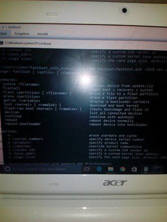

GWollte BL unlocken. Habe alle Treiber.
Den Fastboot.....rar entpackt Usb Debug an.
Handy aus.
Während Vol up drücken am Pc. Die LED blau.
Im Fastboot Ordner shift und Cmd.
fastboot.exe -i0x0fce getvar version enter dann kam das hier siehe Shot. Selbige kommt nach unlock Befehl.
Wo ist der Fehler.
Auf dem Shot schlecht zu sehen ist das man Auswahl Menü zwischen Zahlreichen Dingen hat die das gesamte System betreffen.
hatte Befehl falsch. Dennoch kam waiting for Device.

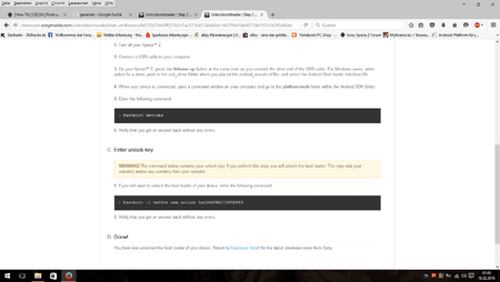

  1. Connect to Fastboot
    1. Turn off your Xperia™ Z.
    2. Connect a USB-cable to your computer.
    3. On your Xperia™ Z, press the Volume up button at the same time as you connect the other end of the USB-cable. For Windows users, when asked for a driver, point to the usb_driver folder where you placed the android_winusb.inf-file, and select the Android Boot loader Interface-file.
    4. When your device is connected, open a command window on your computer and go to the platform-tools folder within the Android SDK folder.
    5. Enter the following command:
    fastboot devices
    6. Verify that you get an answer back without any errors.
  2. Enter unlock key
    WARNING! The command below contains your unlock key. If you perform this step, you will unlock the boot loader. This may void your warranty and/or any warranty from your operator.
    1. If you still want to unlock the boot loader of your device, enter the following command:
    fastboot -i 0x0fce oem unlock 0xAb hier dein Unlockcode der wird automatisch generiert
    2. Verify that you get an answer back without any errors.
  3. Done!
    You have now unlocked the boot loader of your device. Return to Developer World for the latest developer news from Sony.
