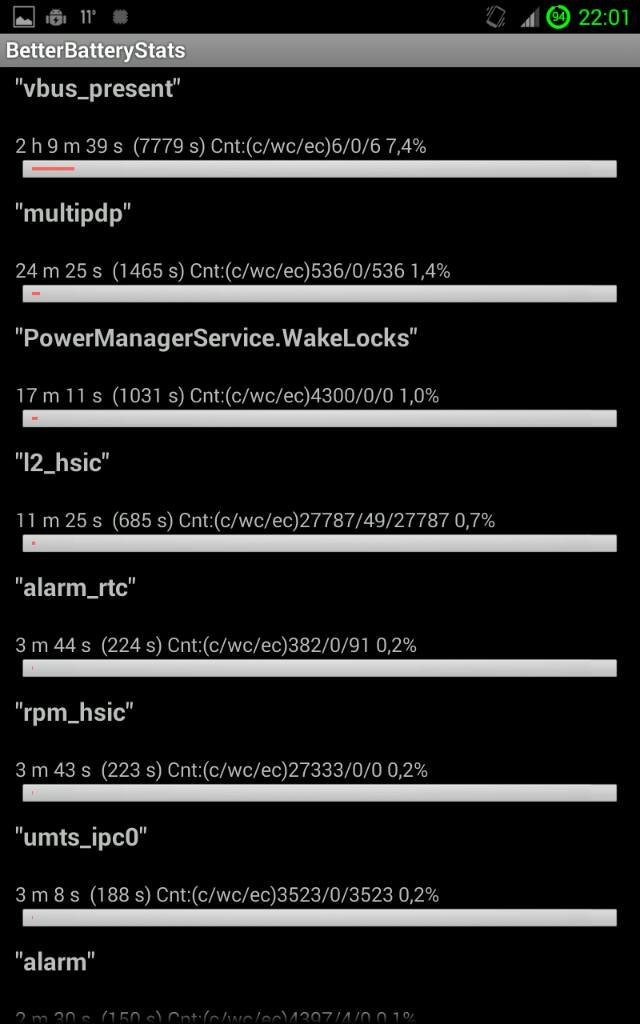

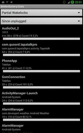

Wollt euch mal fragen ob ihr auf den Screenshots was auffälliges entdeckt und wenn ja was?
Handy seit laden 3h und 30min vom Netz. Davon 3h und 12min im deep sleep.

Hier mal das log file. Hoffe ihr könnt was mit anfangen.
General Information
BetterBatteryStats version: 1.13.4.0
Creation Date: 2014-02-16 16:07:24
Statistic Type: Custom to Current
Since 4 h 22 m 2 s
VERSION.RELEASE: 4.3.1
BRAND: Samsung
DEVICE: GT-N7000
MANUFACTURER: samsung
MODEL: GT-N7000
OS.VERSION: 3.0.93-thor-reborn-V0.37.01-GNOTE-JB4.3
BOOTLOADER: unknown
HARDWARE: smdk4210
FINGERPRINT: samsung/GT-N7000/GT-N7000:4.0.3/IML74K/ZCLP6:user/release-keys
TAGS: test-keys
USER: autobuild
PRODUCT: GT-N7000
RADIO: N7000XXLT3
Rooted: true
Battery Info
Level lost [%]: Bat.: -6% (88% to 82%) [1,4%/h]
Voltage lost [mV]: (4026-3950) [17,4%/h]
Other Usage
Deep Sleep (): 4 h 9 m 3 s (14943 s) Ratio: 72,3%
Awake (): 12 m 58 s (778 s) Ratio: 5,0%
Screen On (): 35 s (35 s) Ratio: 0,2%
No Data Connection (): 3 h 18 m 46 s (11926 s) Ratio: 75,9%
No or Unknown Signal (): 3 h 18 m 46 s (11926 s) Ratio: 75,9%
Poor Signal (): 29 m 3 s (1743 s) Ratio: 8,4%
Moderate Signal (): 34 m 12 s (2052 s) Ratio: 13,1%
Screen dimmed (): 35 s (35 s) Ratio: 0,2%
Wakelocks
com.quoord.tapatalkpro (com.quoord.tapatalkpro.activity.Tapatalk): 2 m 23 s (143 s) Count:14 0,9%
GpsLocationProvider (Android-System): 1 m 11 s (71 s) Count:75 0,5%
RILJ (Telefon): 26 s (26 s) Count:96 0,2%
GCM_CONN_ALARM (Google Play-Dienste): 22 s (22 s) Count:136 0,1%
AlarmManager (Android-System): 20 s (20 s) Count:214 0,1%
AlarmManager (com.devexpert.weather.Android Weather): 16 s (16 s) Count:89 0,1%
AudioOut_2 (1013): 14 s (14 s) Count:6 0,1%
*sync*_gmail-ls_Account {name=bb22e2d43f5e5a4d0d7934952f3efd90, type=com.google} (com.google.android.gm.Gmail): 6 s (6 s) Count:3 0,0%
BBS_WAKELOCK_WHILE_SAVING_REF (com.asksven.betterbatterystats_xdaedition.BetterBatteryStats): 4 s (4 s) Count:2 0,0%
*sync*_com.google.android.location.reporting_Account {name=bb22e2d43f5e5a4d0d7934952f3efd90, type=com.google} (Google Play-Dienste): 4 s (4 s) Count:74 0,0%
*backup* (Android-System): 3 s (3 s) Count:109 0,0%
*sync*_com.android.calendar_Account {name=bb22e2d43f5e5a4d0d7934952f3efd90, type=com.google} (com.google.android.syncadapters.calendar.Google Kalender synchronisieren): 3 s (3 s) Count:2 0,0%
Checkin Service (Google Play-Dienste): 3 s (3 s) Count:73 0,0%
GCM_CONN (Google Play-Dienste): 2 s (2 s) Count:195 0,0%
*sync*_com.android.contacts_Account {name=bb22e2d43f5e5a4d0d7934952f3efd90, type=com.google} (Google Play-Dienste): 2 s (2 s) Count:2 0,0%
lrs (de.ub0r.android.callmeter.Call Meter 3G): 2 s (2 s) Count:21 0,0%
AlarmManager (com.cootek.smartinputv5.TouchPal X): 2 s (2 s) Count:17 0,0%
AlarmManager (Google Play-Dienste): 2 s (2 s) Count:277 0,0%
*sync*_subscribedfeeds_Account {name=bb22e2d43f5e5a4d0d7934952f3efd90, type=com.google} (Google Play-Dienste): 2 s (2 s) Count:138 0,0%
Event Log Service (Google Play-Dienste): 2 s (2 s) Count:163 0,0%
SyncLoopWakeLock (Android-System): 2 s (2 s) Count:267 0,0%
StartingAlertService (com.android.calendar.Kalender): 1 s (1 s) Count:3 0,0%
*sync*_com.android.browser_Account {name=bb22e2d43f5e5a4d0d7934952f3efd90, type=com.google} (Google Play-Dienste): 1 s (1 s) Count:197 0,0%
NetworkStats (Android-System): 1 s (1 s) Count:49 0,0%
*vibrator* (com.quoord.tapatalkpro.activity.Tapatalk): 1 s (1 s) Count:6 0,0%
AlarmManager (Telefon): 1 s (1 s) Count:16 0,0%
ActivityManager-Launch (Android-System): 1 s (1 s) Count:54 0,0%
GmailProviderProviderChangedBroadcastWakeLock (com.google.android.gm.Gmail): 1 s (1 s) Count:5 0,0%
Kernel Wakelocks
"multipdp" (): 7 m 51 s (471 s) Cnt:(c/wc/ec)34/0/35 3,0%
"PowerManagerService.WakeLocks" (): 5 m 45 s (345 s) Cnt:(c/wc/ec)279/0/0 2,2%
"l2_hsic" (): 3 m 28 s (208 s) Cnt:(c/wc/ec)588/20/589 1,3%
"rpm_hsic" (): 1 m 26 s (86 s) Cnt:(c/wc/ec)448/0/0 0,6%
"umts_ipc0" (): 1 m 24 s (84 s) Cnt:(c/wc/ec)165/0/165 0,5%
"alarm_rtc" (): 1 m 17 s (77 s) Cnt:(c/wc/ec)113/0/31 0,5%
"sec-battery-monitor" (): 46 s (46 s) Cnt:(c/wc/ec)134/103/0 0,3%
"radio-interface" (): 44 s (44 s) Cnt:(c/wc/ec)45/0/0 0,3%
"alarm" (): 41 s (41 s) Cnt:(c/wc/ec)357/1/0 0,3%
"tx_hsic" (): 8 s (8 s) Cnt:(c/wc/ec)1131/0/0 0,1%
"PowerManagerService.Broadcasts" (): 4 s (4 s) Cnt:(c/wc/ec)6/0/0 0,0%
"PowerManagerService.Display" (): 1 s (1 s) Cnt:(c/wc/ec)3/0/0 0,0%
"power-supply" (): 1 s (1 s) Cnt:(c/wc/ec)134/0/0 0,0%
"sync_system" (): (0 s) Cnt:(c/wc/ec)3/0/0 0,0%
"secril_fmt-interface" (): (0 s) Cnt:(c/wc/ec)407/0/0 0,0%
"mmc1_detect" (): (0 s) Cnt:(c/wc/ec)151/0/0 0,0%
"KeyEvents" (): (0 s) Cnt:(c/wc/ec)215/0/0 0,0%
"mmc0_detect" (): (0 s) Cnt:(c/wc/ec)151/0/1 0,0%
Processes
system (Android-System): Uid: 1000 Sys: 1 s (1 s) Us: 4 s (4 s) Starts: 0
mmcqd/0 (0): Uid: 0 Sys: 1 s (1 s) Us: (0 s) Starts: 0
kworker/0:2 (0): Uid: 0 Sys: 1 s (1 s) Us: (0 s) Starts: 0
kworker/0:5 (0): Uid: 0 Sys: 1 s (1 s) Us: (0 s) Starts: 0
Alarms (requires root)
com.google.android.gms (): Wakeups: 61
Alarms: 61, Intent: com.google.android.intent.action.GCM_RECONNECT
Alarms: 0, Intent: com.google.android.intent.action.SEND_IDLE
android (): Wakeups: 24
Alarms: 0, Intent: android.intent.action.TIME_TICK
Alarms: 0, Intent: com.android.server.action.NETWORK_STATS_POLL
Alarms: 6, Intent: android.appwidget.action.APPWIDGET_UPDATE
Alarms: 1, Intent: android.appwidget.action.APPWIDGET_UPDATE
Alarms: 3, Intent: android.content.syncmanager.SYNC_ALARM
Alarms: 4, Intent: android.app.backup.intent.RUN
Alarms: 1, Intent: com.android.server.IdleMaintenanceService.action.UPDATE_IDLE_MAINTENANCE_STATE
Alarms: 0, Intent: com.android.server.NetworkTimeUpdateService.action.POLL
com.android.phone (): Wakeups: 15
Alarms: 7, Intent: com.android.internal.telephony.data-stall
Alarms: 8, Intent: com.android.internal.telephony.data-reconnect.default
com.google.android.gsf (): Wakeups: 10
Alarms: 9, Intent: {com.google.android.gsf
Alarms: 1, Intent: com.google.android.intent.action.SEND_IDLE
com.quoord.tapatalkpro.activity (): Wakeups: 8
Alarms: 8, Intent: {com.quoord.tapatalkpro.activity
net.tsapps.topdeals (): Wakeups: 1
Alarms: 1, Intent: {net.tsapps.topdeals
Network (requires root)
10017 (Mobile) (com.quoord.tapatalkpro.activity.Tapatalk): 178.0 KBytes 39,3%
0 (Mobile) (0): 86.0 KBytes 19,0%
10038 (Mobile) (Google Play-Dienste): 81.0 KBytes 17,8%
10040 (Mobile) (com.google.android.gm.Gmail): 33.0 KBytes 7,3%
10055 (Mobile) (com.devexpert.weather.Android Weather): 21.0 KBytes 4,8%
10041 (Mobile) (com.google.android.syncadapters.calendar.Google Kalender synchronisieren): 20.0 KBytes 4,5%
1000 (Mobile) (Android-System): 14.0 KBytes 3,1%
10090 (Mobile) (com.whatsapp.WhatsApp): 9.0 KBytes 2,2%
10019 (Mobile) (com.easy.battery.saver.Easy Battery Saver): 3.0 KBytes 0,8%
10050 (Mobile) (com.android.vending.Google Play Store): 2.0 KBytes 0,7%
10085 (Mobile) (com.cootek.smartinputv5.TouchPal X): 1.0 KBytes 0,4%
CPU States
800 MHz (): 3 m 15 s 1,2%
700 MHz (): 2 s 0,0%
600 MHz (): 2 s 0,0%
500 MHz (): 1 m 11 s 0,5%
400 MHz (): 4 s 0,0%
300 MHz (): 6 s 0,0%
200 MHz (): 11 s 0,1%
100 MHz (): 8 m 4 s 3,1%
Deep Sleep (): 4 h 9 m 3 s 72,3%

Ist das alles noch ernst gemeint?!
Das Logfile ist unbrauchbar!
Wieso? Weil awake und deep-sleep zusammen keine 100 % ergeben.
Wieso das? Ich hab alles so gemacht wie in der Anleitung. Habe 4 Stunden nichts dran gemacht.
