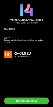

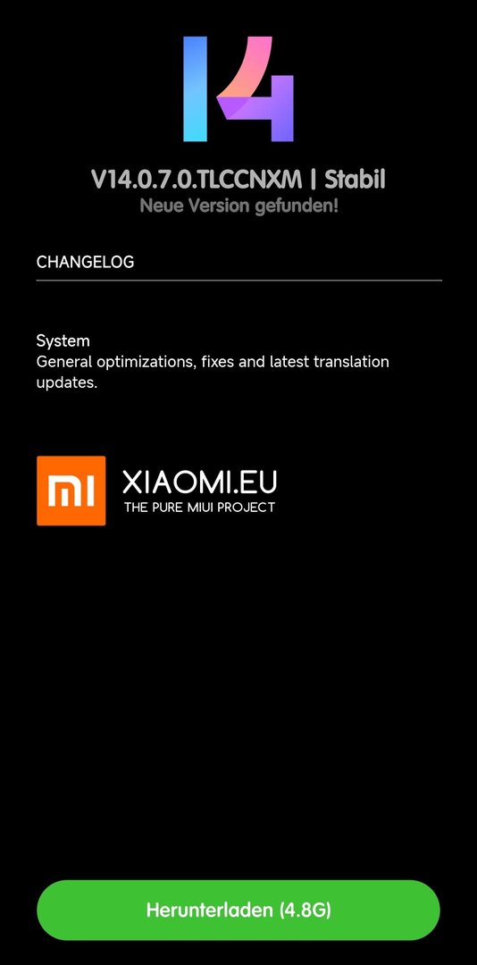

Neue Stable fürs Mi 12
https://sourceforge.net/projects/xi...ti_XM12_V14.0.7.0.TLCCNXM_v14-13.zip/download
