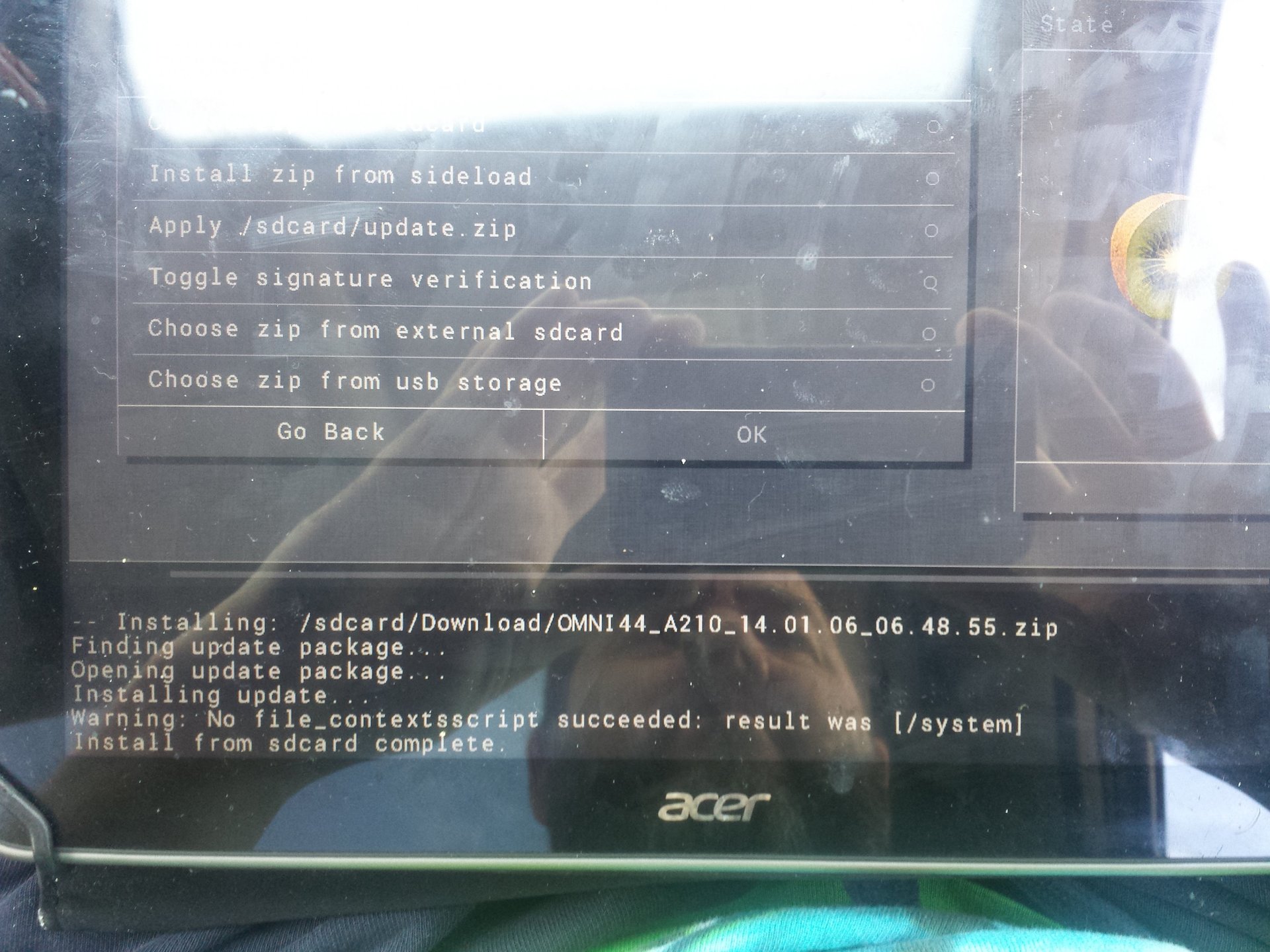

Hi, sorry for my English.
I am trying to install the latest OmniRom and am getting this error. What am I doing wrong?
edit

Two principle things please:
  • You can post in english, but you must add a translation with google translate.
  • Your link is not visible. You can attach a file when posting here.
Usuallly the there are three possible reason for problems:
  • You try to install this rom without having the latest Kiwi++Recovery Version 1.3.1. This Version ist needed. This can be downloaded as Zip and be installed with a CWM Recovery or any older Version of Kiwi++Recovery.
  • You try to install the A211 Version on a A210 (Take care on the Name of the Download-File!)
  • You did format the /system partition before installing. You must not format the system partition, because the ROMs need files from the former installation.

I thought that as of one of the earlier versions of OmniRom, that we did not need a previous installation?

Here's the picture

What do we need to flash before OmniRom? Lightning Rom? CM11? I am familiar with the way you have done system files previously.

You need in any case a former installation, to take the 'Vendor-Blobs' from, but you dont need an Android 4.1 installation, any former installation is usable.
Your Picture does not show any problems...
When you come from a former Version of OmniROM, you can reboot now, when you come from any other ROM you need a 'wipe-data/factory-reset'
Regards Uwe
