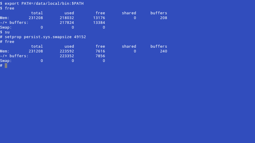

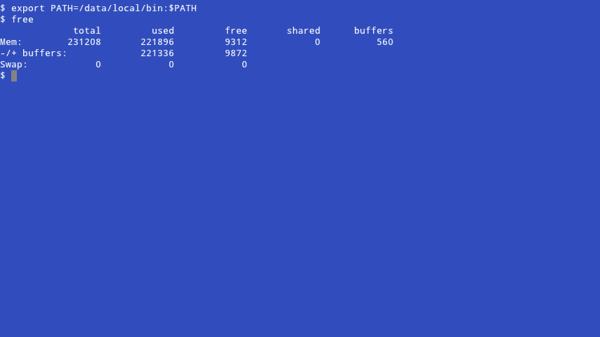

Sacht mal: Hat schon jemand den neuen Swap bei der 7.2.4c ausprobiert? Ich habe 48 MB Linux-Swap in der 3. Partition der SD-Karte und in der Konsole "setprop persist.sys.swapsize 49152" eingegeben und das Gerät neu gebootet. Bei "free" zeigt er mir aber trotzdem keinen Swap an. Funktioniert es bei euch? Mit FuFus 98swapon hat es immer supi funktioniert. Unten zwei Screenshots. Der zweite ist nach dem Booten aufgenommen worden.
In which terminal (der Konsole) you've done it? Have you used the "su" command first? What's the output of 'cat /data/property/persist.sys.swapsize' for you now?

nadlabak schrieb:
System properties have to be set from the running system, not from a completely separate environment as OpenRecovery. (Well, it's actually possible to do it also from OR, but that's a different topic.)
If you've used setprop in OR console, it couldn't work.
Use the Terminal Emulator or ADB shell while the android system is running. And don't forget to issue the "su" command first.

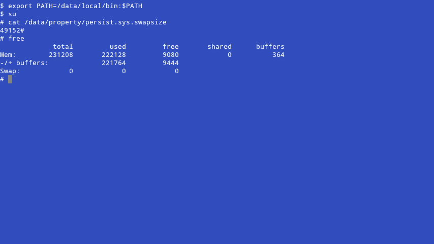

I used it from the built in Terminal Emulator while CM7 was running. Both Screenshots were made from the Terminal Emulator. As you can see I also set the superuser privileges before. There must be another reason...
@ nadlabak: Sorry, I fogot: cat /data/property/persist.sys.swapsize says "49152" as expected. See screenshot.

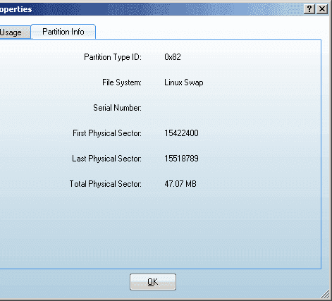

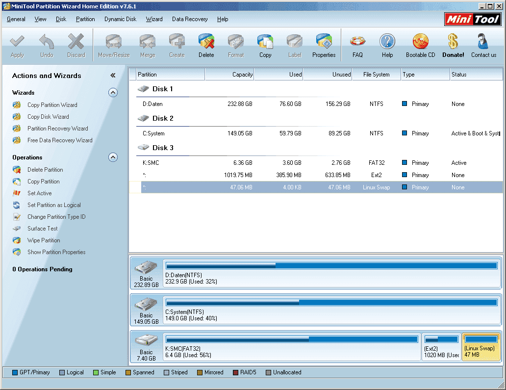

Also some Information about my SD-Card and the Swap Partition.
I got the reason for the problem:
persist.sys.swapsize was slightly bigger than the real size of the swap partition!
If I set persist.sys.swapsize to 32768 it works fine!
So at the moment persist.sys.swapsize MUST NOT be set bigger than the actual size of the swap partition or it will not work at all!
