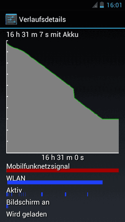

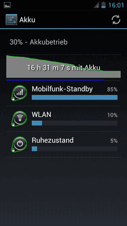

I have no SIM-Card inserted.
This time I didn't enabled the flight mode and I see the following pictures:
attachment.php
attachment.php
It looks like the mobile-part doesn't go into suspend if it has no SIM-Card.
I need to test it with a SIM-Card and also with CM7.
