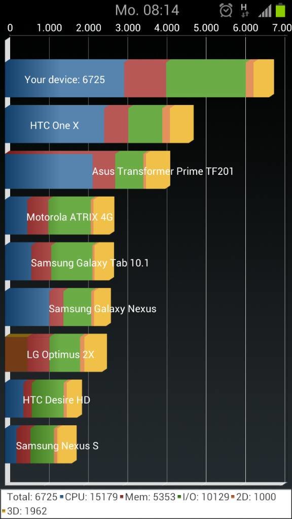

Läuft super.
Lulzq
Row
1600 MHz
Zram off
boeffla tweaks an
