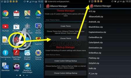

This is more a clean up and fix build...24 themes added to Alliance Manager as seen below and all code cleaned up and issues fixed. Wallpaper support also added so themes will change your lock and home wallpaper. Hopefully you guys will be happy with it. Oh and added Note 4 weather widget with thanks to @Tamerlan2009
Point to note: To experience the themes as intended you should use AOSP theme. They will work just fine on Stock and BlackGlass but the screenshots were all taken on AOSP theme
Geht denn jetzt viper4android mit der neuen Version?
Hatte es bisher noch nicht installiert ...
Hi die Rom läuft ja verdammt gut. Bin echt zufrieden.
Eine Frage hätte ich da aber. Kann man irgendwo noch fertige Themes runterladen?
@nominator2204:
siehe Spoiler :thumbsup: :flapper:
