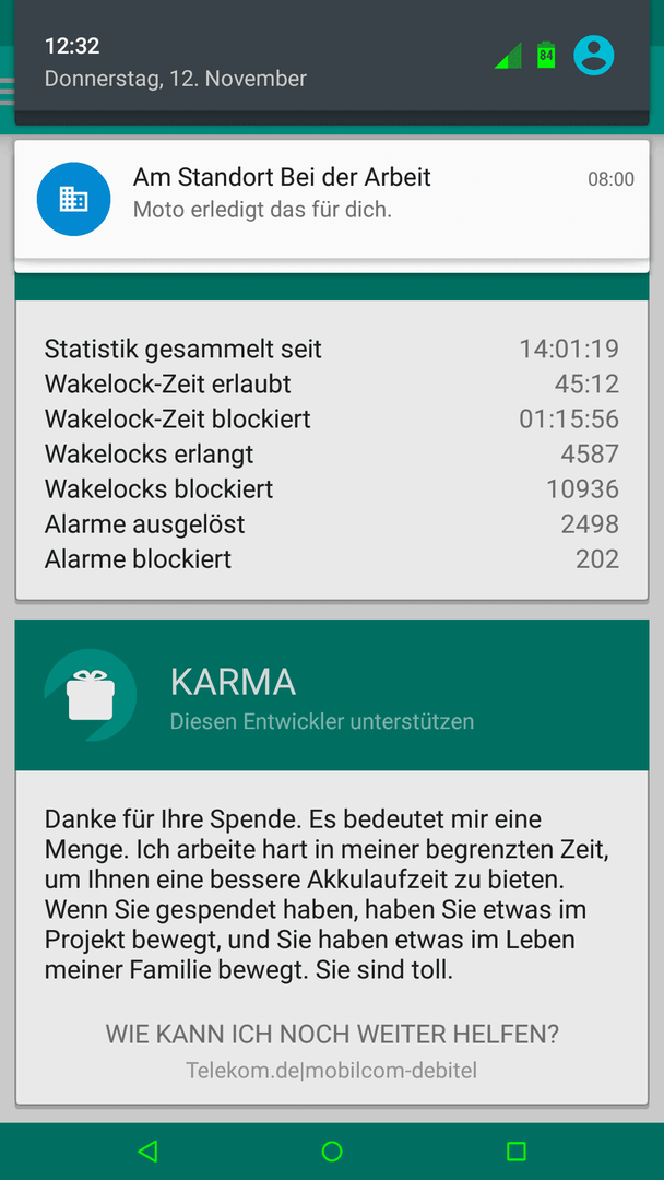

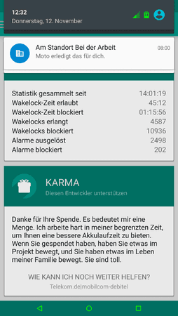

im Anhang mal ein Screenshot, was mit den vorne angegebenen Werten bei mir raus kommt.
Bei 14 Stunden Standby wurde mehr als 1h Wake geblockt, nur 45min erlaubt. mehr als die hälfte wurde also blockiert.

11-12 12:23:25.878 I/Xposed  ( 1567): Amplify: Allowing Wakelock NlpWakeLock.  Max Interval: 240000 Time since last granted: 263236
11-12 12:23:26.079 I/Xposed  ( 1567): Amplify: Allowing Wakelock LocationManagerService.  Max Interval: 240000 Time since last granted: 262799
11-12 12:26:37.333 I/Xposed  ( 1567): Amplify: Allowing Wakelock NlpCollectorWakeLock.  Max Interval: 240000 Time since last granted: 454610
11-12 12:27:41.965 I/Xposed  ( 1567): Amplify: Allowing Wakelock NlpWakeLock.  Max Interval: 240000 Time since last granted: 256086
11-12 12:28:35.468 I/Xposed  ( 1567): Amplify: Allowing Wakelock LocationManagerService.  Max Interval: 240000 Time since last granted: 309389
11-12 12:30:08.303 I/Xposed  ( 1567): Amplify: Allowing Alarm com.android.internal.telephony.data-stall.  Max Interval: 720000 Time since last granted: 2548018
11-12 12:30:44.335 I/Xposed  ( 1567): Amplify: Allowing Wakelock NlpCollectorWakeLock.  Max Interval: 240000 Time since last granted: 247001
11-12 12:31:33.999 I/Xposed  ( 1567): Amplify: Allowing Wakelock NfcService:mRoutingWakeLock.  Max Interval: 7200000 Time since last granted: 11341195
11-12 12:31:34.460 I/Xposed  ( 1567): Amplify: Allowing Wakelock GpsLocationProvider.  Max Interval: 240000 Time since last granted: 750390
11-12 12:31:35.591 I/Xposed  ( 1567): Amplify: Allowing Wakelock *net_scheduler*.  Max Interval: 7200000 Time since last granted: 7679851
11-12 12:31:36.744 I/Xposed  ( 1567): Amplify: Allowing Wakelock Icing.  Max Interval: 7200000 Time since last granted: 12560619
