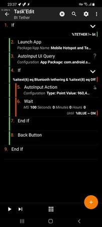

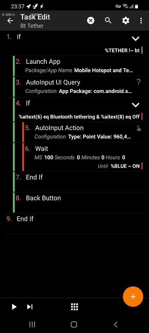

Good time of the day.
I don't speak German, so please forgive me for that.
Found your forum while trying to solve similar problem and thanks to your suggestions (Google translated) tweaked Android Settings.
The answer found on Reddit. Need to install AutoInput
It took me a while to understand how can I adjust it for my SG 21 Ultra with small letters DPI.
First of all, my task (attached as XML and as a screenshot)
A1: If [ %TETHER !~ bt ]
A2: Launch App [
Package/App Name: Mobile Hotspot and Tethering
Exclude From Recent Apps: On
Always Start New Copy: On ]
A3: AutoInput UI Query [
Configuration: App Package: com.android.settings
Timeout (Seconds): 20
Structure Output (JSON, etc): On ]
A4: If [ %aitext(6) eq Bluetooth tethering & %aitext(8) eq Off ]
A5: AutoInput Action [
Configuration: Type: Point
Value: 960,470
Action : Click
Timeout (Seconds): 23
A6: Wait Until [
MS: 100
Seconds: 0
Minutes: 0
Hours: 0
Days: 0 ]If [ %BLUE ~ ON ]
A7: End If
A8: Back Button
A9: End If

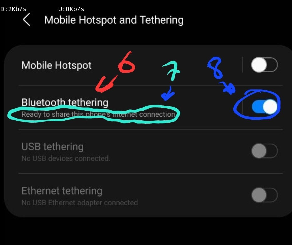

Now how I did it.
First IF not working for me (No %TETHER variable), but not critical for now. Maybe will find later.
A2 - In my phone it was "Mobile Hotspot and Tethering" and not "Mobile Hotspot and Tethering"
In order to see system apps, I had to:
Go to apps in "LaunchApp", check "all", then to go out, press on crossed arrows and then to go again to apps.
After A3, in order to know exact numbers and values of %aitext() (or "%aitext(6) = %aitext(8)), you can use a "popup" action.
Please pay attention, that I used 6 and 8. Because 7 is description (screenshot attached).
Then I built A4 based on my tests.
A5 - in order to find X and Y of tethering on button, just went to Android Developer options and turned on "Pointer location".
That's all. Tested and it's working as expected.

  • Bt_Tether.tsk.xml
