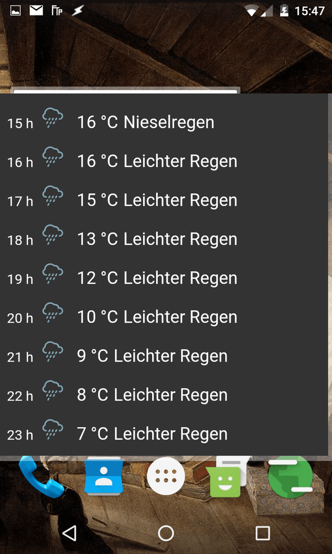

forecast.io Wetter je Stunde für die nächsten 24h (braucht kostenlosen [1000 anfragen pro tag] apikey)
Code:
Wetter Vorhersage stdl (145)
   A1: Get Location [ Source:Net Timeout (Seconds):15 Continue Task Immediately:Off Keep Tracking:Off ]
   A2: JavaScriptlet [ Code:
function sendRequest(url)
  var xhr = new XMLHttpRequest();
  xhr.open("GET", url, true);
  xhr.onerror = function() {
  setLocal("%out", "FEHLER");
  exit();
  xhr.onreadystatechange = function() {handleReply(xhr) };
  xhr.send();
function handleReply(xhr)
  if(xhr.readyState == 4) {
  if (xhr.status == 200) {
  var jsonobj = JSON.parse(xhr.responseText).hourly.data;
  var ausgabe = "";
  // nur 1 tag -24
  for (var i = 0; i < (jsonobj.length-24);i++) {
  if (i < (jsonobj.length - 24 - 1) ) {
  ausgabe += "Um "+(convertToDate()) + " ca. "+Math.round(jsonobj[i].temperature) + "°; " + jsonobj[i].summary+"\n\n"
  } else {
  setLocal("%out", ausgabe);
  exit()
  function convertToDate() {
  var date = new Date(jsonobj[i].time*1000);
  return date.toTimeString().split(" ")[0]
sendRequest( "https://api.forecast.io/forecast/apikey/"+global("%LOCN")+"?units=si&&exclude=currently,minutely,daily&lang=de" )
Libraries: Auto Exit:Off Timeout (Seconds):45 ]
   A3: Show Scene [ Name:WetterSzene Display As:Dialog Horizontal Position:100 Vertical Position:100 Animation:System Show Exit Button:Off Continue Task Immediately:On ]

WebView Szene:
Source: (z.b.) TskWebView/out.html
Allow Phone Access
(optional sonst scheint tasker zu crashen falls man lange auf das Fenster tippt und die Textauswahl erscheint) Support Popups)
TskWebView/out.html
z.B.: (braucht icons mit entprechendem namen in TskWebView/icons

img.setAttribute ("src", "/sdcard/TskWebView/icons/"+icon+".svg")
return img;
//2. 3., 4 Wert text.
function addText( t ) {
var txt = document.createElement("text");
txt.innerHTML = t;
return txt;
  // cleanup
  x.parentNode.removeChild(x);
</script>
<style>
body
  color: #ffffff;
  background: #333;
  text-align: left
  height: 1.5em;
  width: 1.5em;
  margin-left: 10px;
  margin-right: 10px;
text > text
  font-size: 20px;
  margin-left: 6px
p
  margin-top: 1em;
  margin-bottom: 1em;
</style>
<body onload='sendRequest( "https://api.forecast.io/forecast/"+global("%ApiKeyForecast")+"/"+global("%LOCN")+"?units=si&exclude=currently,minutely,daily&lang=de" )'>
<text id="status"></text>
<div id="output">
</div>
</body>
</html>
Sieht dann z.b. so aus
edit; überflüssiges entfernt
edit2: kleiner änderung + alternative
