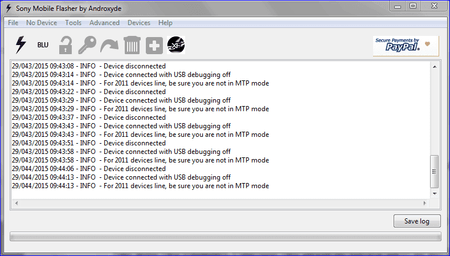

hab alles neu installiert, Flashtool neu gestartet kommt dann so ein Meldung siehe Foto
29/038/2015 10:38:26 - INFO - Flashtool Version 0.9.18.6 built on 30-05-2015 22:30:00
29/038/2015 10:38:26 - INFO - Executing search strategies to find proxy selector
29/038/2015 10:38:27 - INFO - No proxy found for IE. Trying next one
29/038/2015 10:38:27 - INFO - No proxy found for firefox. Trying next one
29/038/2015 10:38:27 - INFO - No proxy found for java. Trying next one
29/038/2015 10:38:27 - INFO - Syncing devices from github
29/038/2015 10:38:27 - INFO - Scanning devices folder for changes.
29/038/2015 10:38:36 - INFO - Pulling changes from github.
29/038/2015 10:38:37 - INFO - Devices sync finished.
29/038/2015 10:38:45 - INFO - Device connected with USB debugging off
29/038/2015 10:38:45 - INFO - For 2011 devices line, be sure you are not in MTP mode
29/039/2015 10:39:06 - INFO - Selected Bundle for Sony Xperia SP (C5303). FW release : 12.1.A.1.207. Customization : Telekom DE 1272-4703
29/039/2015 10:39:06 - INFO - Preparing files for flashing
29/040/2015 10:40:35 - INFO - Please connect your device into flashmode.
29/040/2015 10:40:44 - INFO - Device disconnected
29/041/2015 10:41:11 - INFO - Opening device for R/W
29/041/2015 10:41:11 - INFO - Start Flashing
29/041/2015 10:41:11 - INFO - Processing loader.sin
29/041/2015 10:41:11 - INFO - Checking header
29/041/2015 10:41:11 - ERROR - Processing of loader.sin finished with errors.
29/041/2015 10:41:11 - INFO - Ending flash session
29/041/2015 10:41:11 - ERROR - Error flashing. Aborted
29/041/2015 10:41:12 - ERROR - Drivers need to be installed for connected device.
29/041/2015 10:41:12 - ERROR - You can find them in the drivers folder of Flashtool.
29/041/2015 10:41:14 - INFO - Device connected in flash mode
Noch immer der selbe Fehler was kann es da haben?
Hab alle Treiber installiert die ein "S" beinhalten..
Die Fehlermeldung kommt immer nachdem ich das Handy in den Flash mode setze.
Das sieht stark nach nem Treiberproblem aus. Versuch mal alle Treiber zu löschen über den Geräte Manager (dazu musst du unsichtbare Geräte anzeigen aktivieren, google).
Nachdem alle Treiber gelöscht sind PC Neustart und über flashtool die nötigen Treiber installieren, die auch für dein Gerät gedacht sind.
