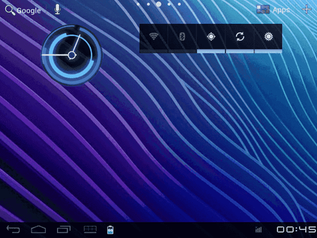

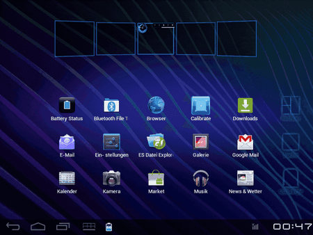

AnTuTu: RAM ext3 = 298, RAM ext4 = 374
:thumbup:
