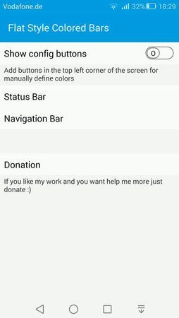

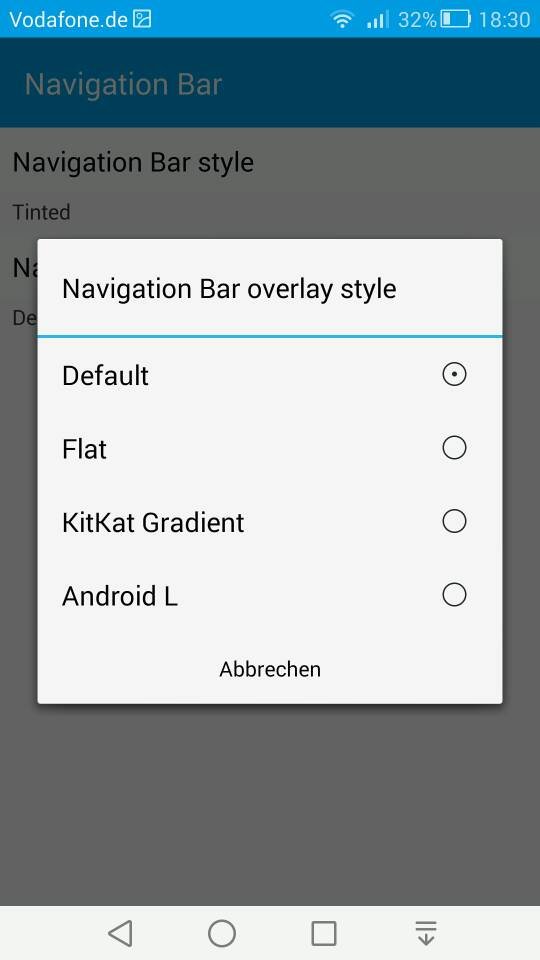

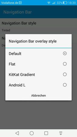

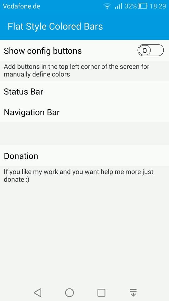

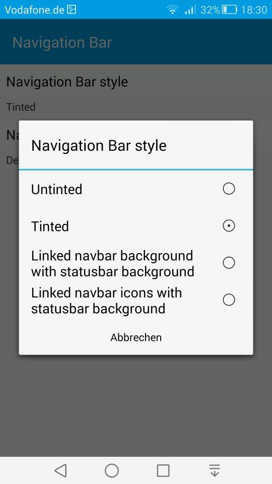

Flat Style Colored Bars, gefällt mir sehr gut :)
FREE
- Change background colors of your Status & Navigation bars
PRO >> more about activating <<
- Change overlay styles & colors for your Status & Navigation bars
ff879e8208f9997fc40e41229fe61a29.jpg84fd4e89167693073637a754250e6424.jpg2bf6f8bcb28c8a093efb229d535b657c.jpga53b7ec4b5a416148ef0679b55af9fd1.jpg5a74e3832729cd6e9d225bfcbf5fd694.jpg
