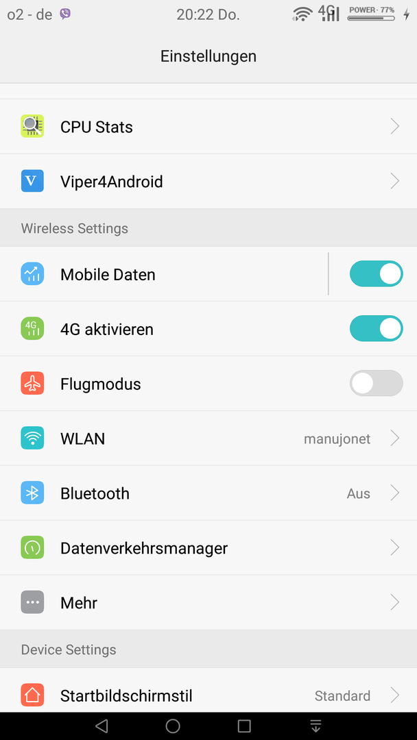

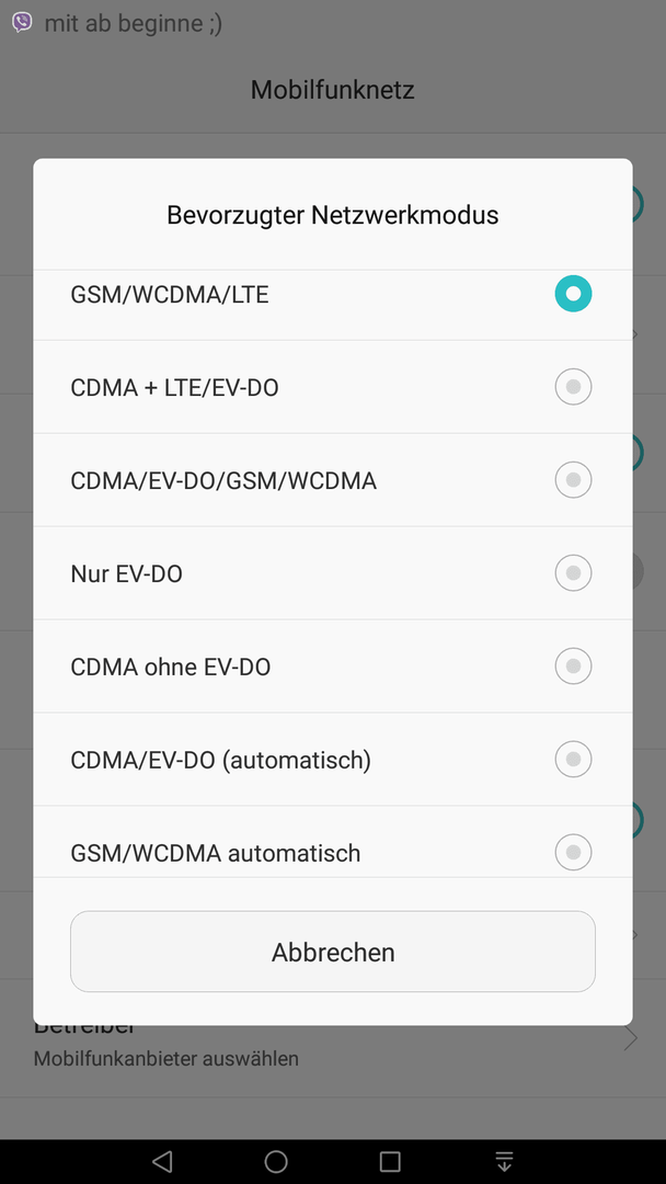

Why you want deactivate Mobile data? You cannot receive Chat messages then if you are not in WLan.
Anyway, 4G can be deactivated in settings easily. If you use fromfuture settings which come with Gratitude v3.1 - see screenshot 1. If you have flashed the original settings from v3 you can deactivate 4G (LTE) only in Network Settings - see screenshot 2. (use GSM/WCDMA - or only GSM) For me it makes no sense.
