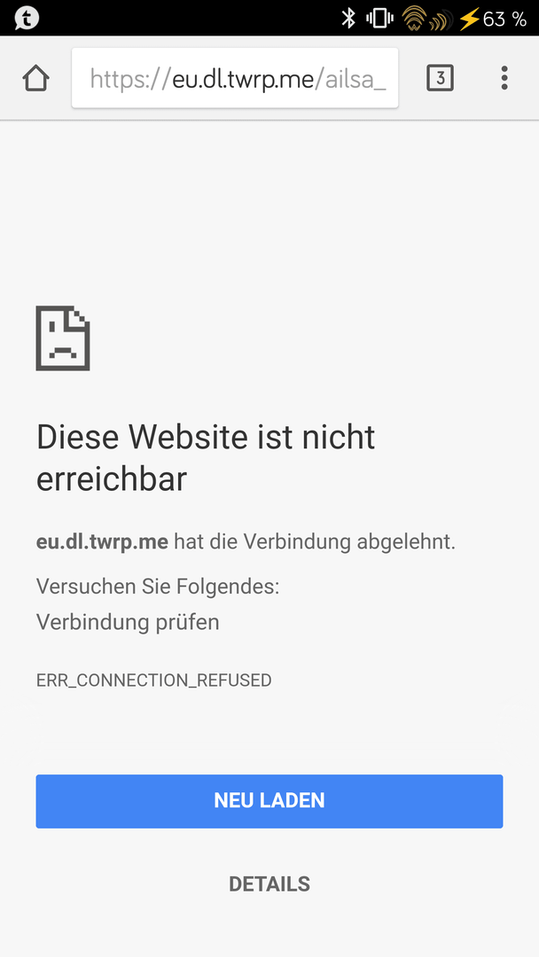

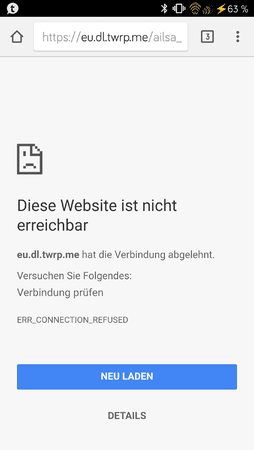

Wir besitzen die Europäische (G) Version.Current and past versions of TWRP can be found at one of the mirrors below
Primary (Americas)
Primary (Europe)
TWRP Install (Requires TWRP 2.8.4 or higher already installed):
Quelle:ZTE Axon 7
