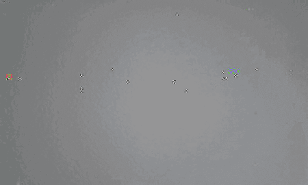

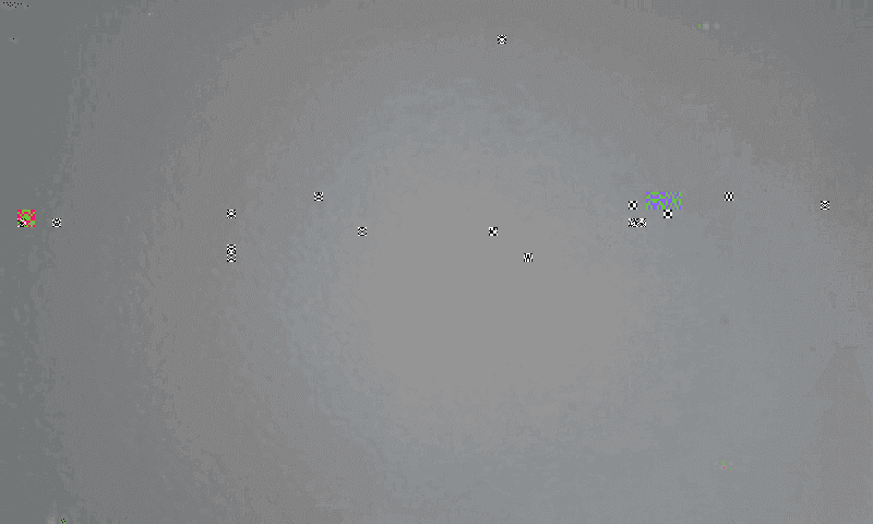

I currently have this custom ROM installed (CyanogenMod 7.2.0 Stable) and I love it.
I have 1 problem when recording video and I was wondering if others could try out their phone to see if it is a ROM problem or something else.
When recording video with quality set to 'High (30m)' it records correctly. But when you play it back I get speckles all over the screen. Any ideas why? (I have an 8GB microSDHC CLASS 4 card installed.)
Please make a screenshot.
For the record: this is a low cost phone which has a very poor camera and cpu. Encoding quality is really low even when using the "high" setting and you'll always get compression artifacts all over the video.
Thanks for the reply.
You are correct - it is a low cost phone.
But I was wondering if this happens when YOU record video?
It happens immediately on every single occasion during playback, so it will not be hard for you to test it for me.
I am trying to ascertain if this problem only happens to my phone?
CPU overclocked?
