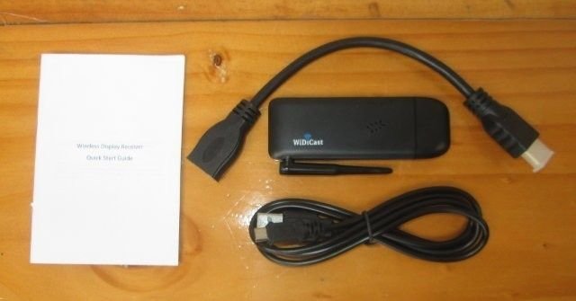

EZCast hat nun einen Namen! :thumbup:
WiDiCast EC-E2
WiDicast EC-E2 Specifications
Like all other EZCast adapters,WiDicast is based on Actions Semi SoC:
  • SoC- Action Semi AM8251 @ 600MHz (MIPS)
  • System memory – 128 MB DDR3 RAM
  • Storage – 128 MB NAND Flash
  • Video output – HDMI
  • Wi-Fi – 802.11 b/g/n Wi-Fi
  • Standards – Miracast, Airplay, DLNA, and EZCast
  • Video container formats – avi, .divx, .mkv, .ts, .dat, .vob, .mpg, .mpeg, .mov, .mp4, .rm, .rmvb, .wmv,
  • Audio formats / codecs – MP1/MP2,/MP3, WMA, OGG, ADPCM-WAV, PCM-WAV, AAC etc
  • USB – micro USB port for power
  • Power – 5V/0.5A
  • Dimensions – 94.5 x 33 x 9.9 mm. Including antenna: 94.5 x 41.2 (width) x 9.9 mm
  • Weight – About 20 grams
The device is said to run Linux 3.0.8. EZCast mode is supported with Android 4.0 or above, iPhones with iOS 6.0 or greater, Windows XP/7/8, and Mac OS 10.7 or greater. EZMirror (Miracast) is supported with Android 4.2.x devices with Wi-Fi direct support.
WiDicast comes with a short HDMI cable, a USB cable for power, and a user’s manual in English. The device comes with an external Wi-Fi antenna, an HDMI male port, and a micro USB port for power.
WiDicast is available for € 26,65 on Aliexpress, and € 30,68 on DealExtreme both including shipping.
Quelle: http://www.cnx-software.com/2013/12/27/widicast-ec-e2-wi-fi-display-ezcast-miracast-hdmi-dongle-review/
