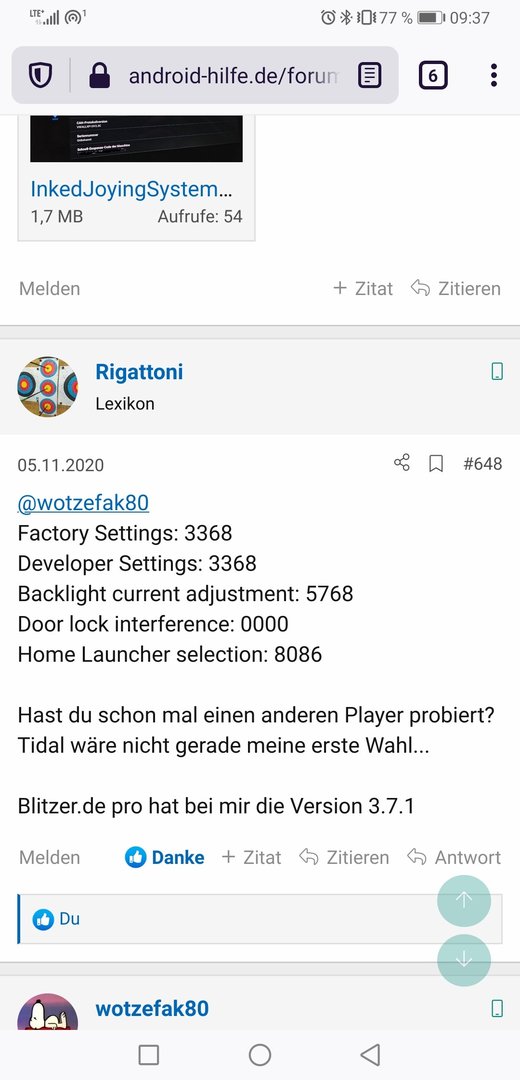

Kennt jemand noch andere PINs für die Einstellungen? Die 3368 konnte ich googeln, passt aber nicht immer.

Pin 3368 passte bei meinem bisher überall.

3368 ist korrekt, zudem noch 8086 für UI Einstellungen.

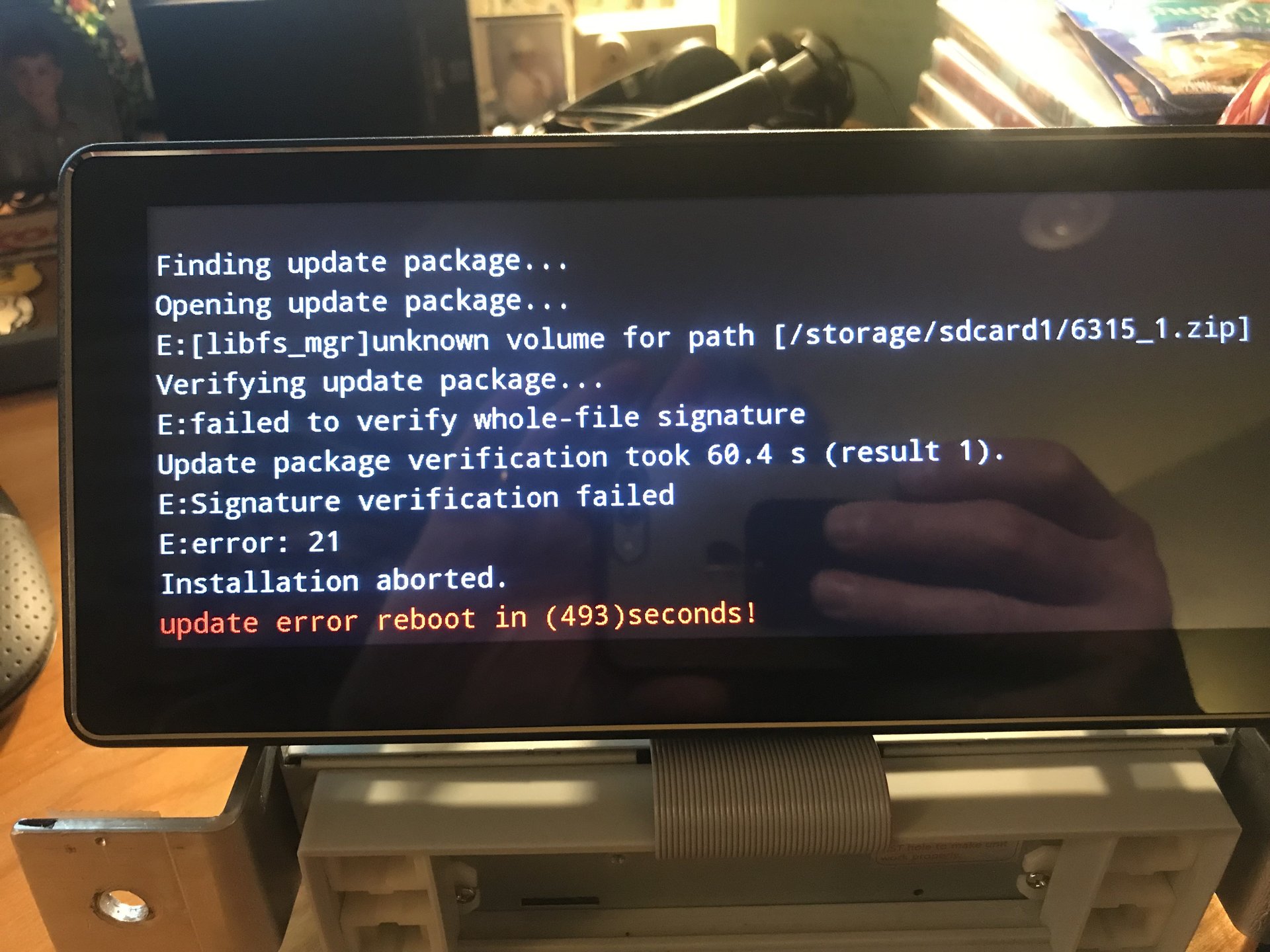

Newbie here. Trying to root my new Joying 8.8, JY-HQS01N4G-1, Android 10 head unit, UIS7862 so that I can resize the screen to fit an old C5 Corvette (2002). Has anyone developed the files for this unit? I used an excellently documented process from a video from Youtube that may have been for an earlier version, as the first time I used it, it created a "soft brick" where the boot logo displayed and stuck there. A reload of the original firmware cleared it. The second attempt provided two error messages shown on the screen:
- E: [libfs_mgr] unknown volume for path [/storage/sdcard6315_1.zip]
- E: failed to verify whole file signature
- E: Signature verification failed
- E:Error 21
- Installation aborted.
The above mentioned instructions say to run the batch file as an administrator. For some reason, my personal computer with Windows 10 as well as an older Microsoft 7 machine will not do it. The screen just blinks and then it is over with no action. This appears to be a common problem as evidenced by information on the internet. The batch file does run when clicked on normally, and provides the scripts shown in the video including that the file was signed. But the error messages above would seem to indicate that the batch file did not run properly.
Thoughts?
Any information is greatly appreciated.
Thank you!
