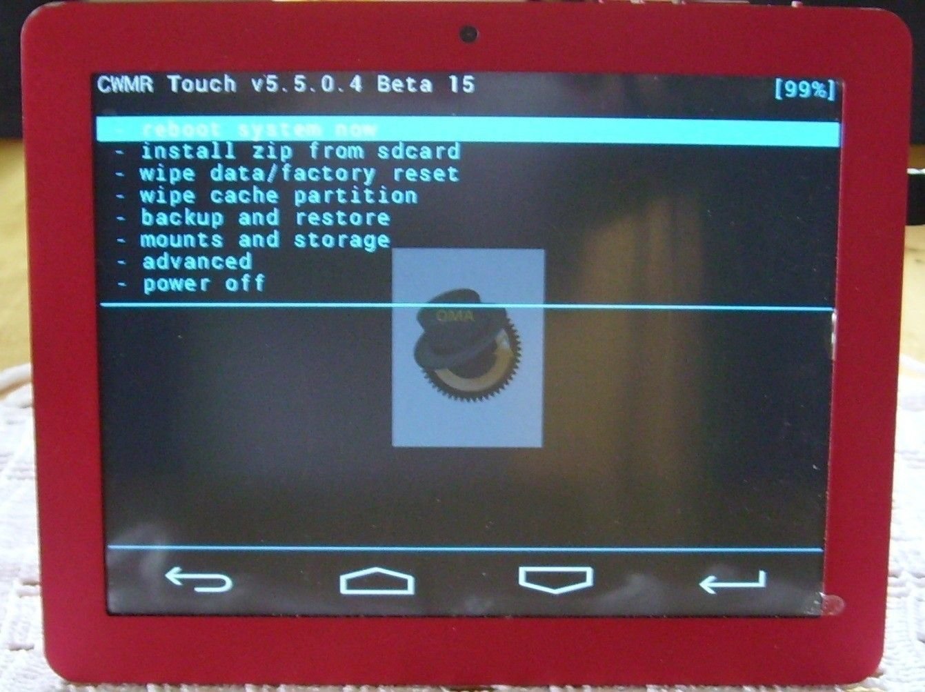

Did you started the RKAndroidTool in AdminMode? You need to do that because otherwise the xpress won't start after flashing.
So, do the steps you mentioned above but start the tools in Admin Mode. That way, everything should work.
If everything works and your xpress start you will get to the CWM.
Now:
- do "wipeData/factory Reset
- now reboot
moving in menu does work with the volume- and the power on/off button
After doing those steps, it will take a while to boot, because the dalvic Cache will be filled, so don't get nervous while waiting.
If after the first boot the sd-card will be shown as damaged, format this card directly after booting your xpress.

this didn't help =( run as admin Win 7 x64
I try to flash this one and it boots normaly
So you run the tools as admin (right click - open as admin)?
Did you rename the xpress kernel inside rockdev - images to "kernel.img"?
Did you choose the correct path to that kernel in the rkandroid tools?
Yes as right click "run as administrator"
No i didn't rename kernel =)
Will try again, and some question i need to check loader section in RK tools?
ok, rename the xpress kernel to just "kernel.img" (.img only if you see the endings in windows).
As i know, you don't need to check any other sections in the RK tools, just leave them as they are and choose the correct path to the renamed kernel.img

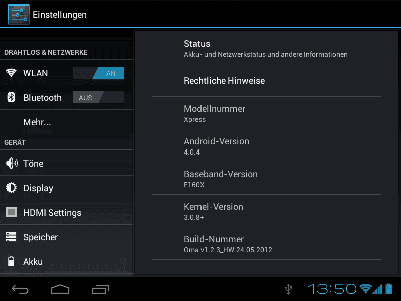

Für den Xpress dann auch noch die Oma ICS v1.2.3. Bitte hierzu den anliegenden Kernel flaschen. Damit
sollte die Akkuanzeige jetzt richtig funktionieren.
Zur Änderung der Kennung den anliegenden fix über die CWM (install zip from sdcard) einpielen.
Bitte Rückmeldung, ob die Akkuanzeige jetzt funktioniert. Dann mache ich noch ein eigenes Image für den Xpress ;-)
Danke an Astralix und wusel!

Danke für die schnelle Antwort @jackdaniel709 - Läuft jetzt. Aber kann es sein, dass die Akkuanzeige mit der neuen Rom und neuen Kernel auch noch fehlerhaft ist. Tablet ging bei 30% einfach aus. Erst nach ner Minute am Strom konnte ich es wieder starten.
Lade das Tab mal komplett auf. Dann in die CWM booten und unter advanced die Battery Stats wipen.
:thumbup:

Die Datei auf die SD-Karte kopieren. Dann Netzkabel ab, M-Taste festhalten und Power-On drücken, bis die CWM kommt.
Dort dann install zip from sdcard. Nach der Installation dann reboot system now.
:thumbup:
