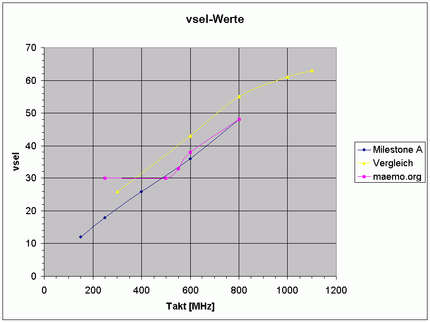

You are using insanely low vsel values!
Your CPU must be running in error correction mode most of the time.
No wonder you are experiencing weird issues.
Fix your vsels.
See e.g. this table for inspiration: http://wiki.maemo.org/Overclocking#Voltage_Table
I also recommend to get rid of the 150MHz opp slot (anything below 250Mhz is actually not helping the battery at all).

nadlabak schrieb:
This page is quite hard to access (long waiting times)...
I found some reasonable vsel Values on OPPtimizer Projekt - Milestone Overclock for OMAP4 Devices - Droid Bionic Development - RootzWiki. They are shown in the yellow graph in the chart below. My values are in the blue graph. They do not differ so much.
The red graph shows the values marked as "ideal" on maemo.org. They are looking VERY curious! The physical dependency between the frequency and the voltage in a processor is nearly linear! So the red values seem inadequate to me below 500 MHz. Though above 500 MHz they do not differ from the values I use right now!?!
All this looks much crazy to me.
Please try to determine:
Is the 'cpufreq stuck at the highest frequency issue' specific to the conservative governor in use?
Are you able to reproduce it when the interactive gov is used?
And another dimension to the question:
Are you able to reproduce it when the CM7 stock vsel values are used?
Say linear again, I dare you, I double dare you, say linear one more time...
Okay, okay. :) Nearly linear excluding extremely low or high frequencies - of course! Maybe the assumed linearity below 400 MHz may have been the problem. I will not give up before I found the exact reason ;).
fipsy: Why have you decided to use vsel values for completely different CPU family?
OPPtimizer project targets OMAP 4 family: 45nm technology CPUs with Cortex-A9 core.
Our OMAP3430: 65nm technology CPU with Cortex-A8 core.

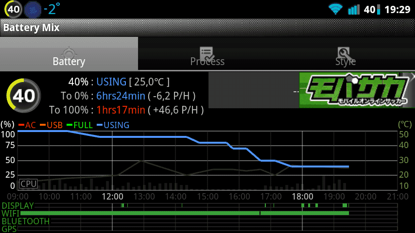

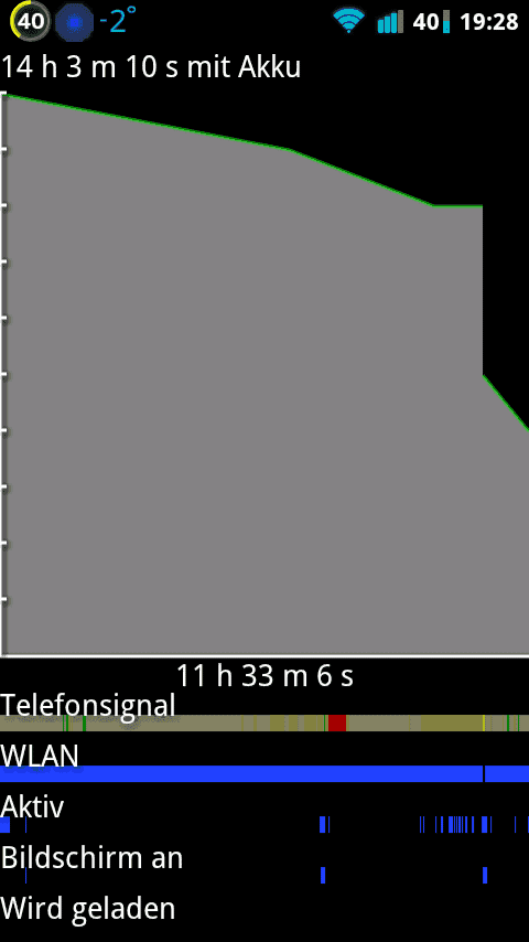

Oh ich seh grad, dass ich zwischen 14:20 und 17Uhr nen drain hatte. Dabei habe ich um 14:10 aufs Handy geschaut, Uhrzeitcheck und gucken ob wer geschrieben hat und direkt wieder den Bildschirm ausgemacht und weggelegt.
In dieser Zeit hatte ich eine CPU Auslastung von Nahezu 0% und der Akku macht nen schoenen Abflug.
Screen uppe ich gleich.
Vielleicht hilfts ja zur Fehlersuche, dass er bei mir jetzt praktisch durchs kurz aktivieren des Displays und nach 2 Sek wieder ausschalten ausgeloest wurde?
Noch etwas Interessantes: Scheinbar hatte ich um kurz vor 5 einen reboot, jedenfalls sieht man ja, dass kurz das Wlan weg war.
Ich tippe einfach mal drauf los und sage, dass ich da aus welchem Grund auch immer einen Modem-restart hatte - Ohne PIN-Eingabe nach dem reboot.
Hatte den Modem-Fehler leider schon mehrfach, aber zu 80% wenn ich jemanden anrufen wollte und der Gespraechspartner grade abgenommen hat und ich ihn 1-2 Sekunden hoeren konnte oder wenn ich angerufen wurde und den Anruf grade entgegengenommen hatte.
Ich weiss zumindest, dass ich zu 100% um 14:10 und um 16:55 das Telefon fuer wenige Sekunden zum Uhrzeitcheck angemacht habe, beide male NICHT den Lockscreen entsperrt habe.
Das einfache erwecken kann es aber nicht gewesen sein, dadurch ist das Wlan-Signal ja nicht fuer nen Moment weg ;).
Innerhalb dieser Zeit wurde das Handy weder bewegt noch beruehrt. Er lag einfach so da, ganz allein im Rucksack :D.
