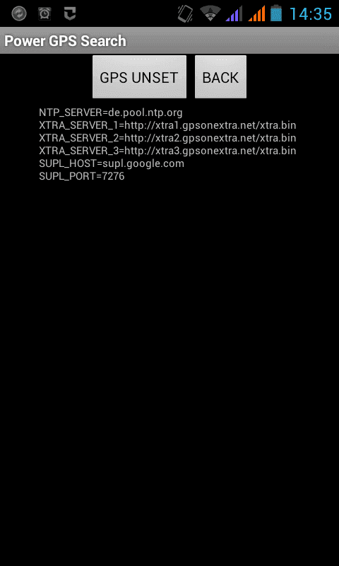

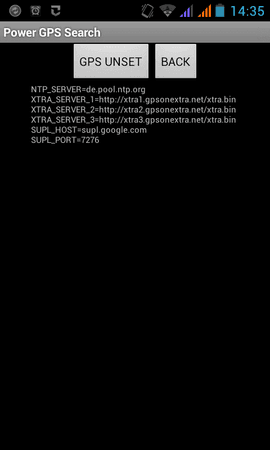

Yes, I was right. FasterGPS has just created that GPS.conf file in /etc folder. And there is only one string in this file, that defines the ntp server (for me I chose the Russian one).. The question is whether Cynus T1 will see this file and use it for GPS-module...
Sent from my Cynus T1 using Android-Hilfe.de App

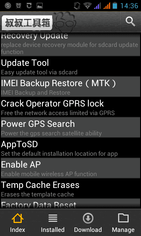

I hope that the system will see the file. Out-of-the-box I had this file, but it was empty. No string in it. So I used the "MTK MobileUncle Tools" and created a new one with the option "Power GPS Search" and the one that was created included the path to the chinese server.
Then I used "FasterGPS" and it changed the values into "de" for Germany.

The files (gps.conf & gps.conf.bak) are included in both directories. :confused2:
With the same date of creation. This must have been done by the system, I never changed anything.
And: YES, i get a sat-fix without assistence.

So the method with MTK MobileUncle Tools with Power GPS Search -> GPS SET and Faster GPS with its Choose continent and region really works) Thanks!
