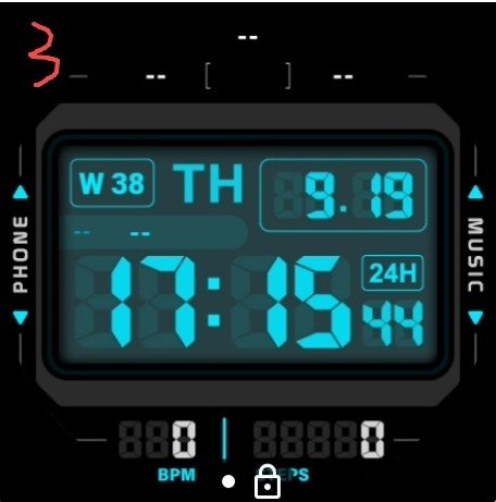

Using HMKWatch Digital 035 as example, I just tested the Pro 5 running Wear OS 3.5, the Pro 5 running Wear OS 4, and the Pixel watch running Wear OS 4, and all three of them exhibited exactly the same behavior. Therefore, we can rule out the possibility that the issue lies with the Pro 5 running Wear OS 4 as the same problem has been reported on the Pixel Watch as well.
Currently, the main issue that the watch face developer needs to address is the cross-day data updating problem. As you can see in the video, the watch face still displays data from yesterday, even though I have only taken 125 steps today.
As for the issue where all data is displayed as 0 or empty when the screen is locked("Picture 3" should have the same issue you encountered.), this is expected behavior since third-party apps do not have permission to access data when the device is locked. You can observe the differences between the pre-installed watchface and the third-party watchface when the screen is locked.
Qiang from Mobvoi.
