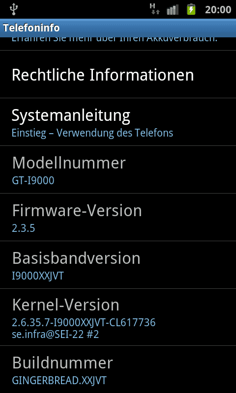

1.2 Anmerkungen:Android-Version: 2.3.5 (!)
PDA: I9000XXJVT
MODEM: I9000XXJVT
CSC: I9000OXAJVT [CPW, DBT, KOR, XEO, XEU]
Build date: Thu Sep 29 11:43:43 KST 2011
Swype: 2.26.19015.1027
